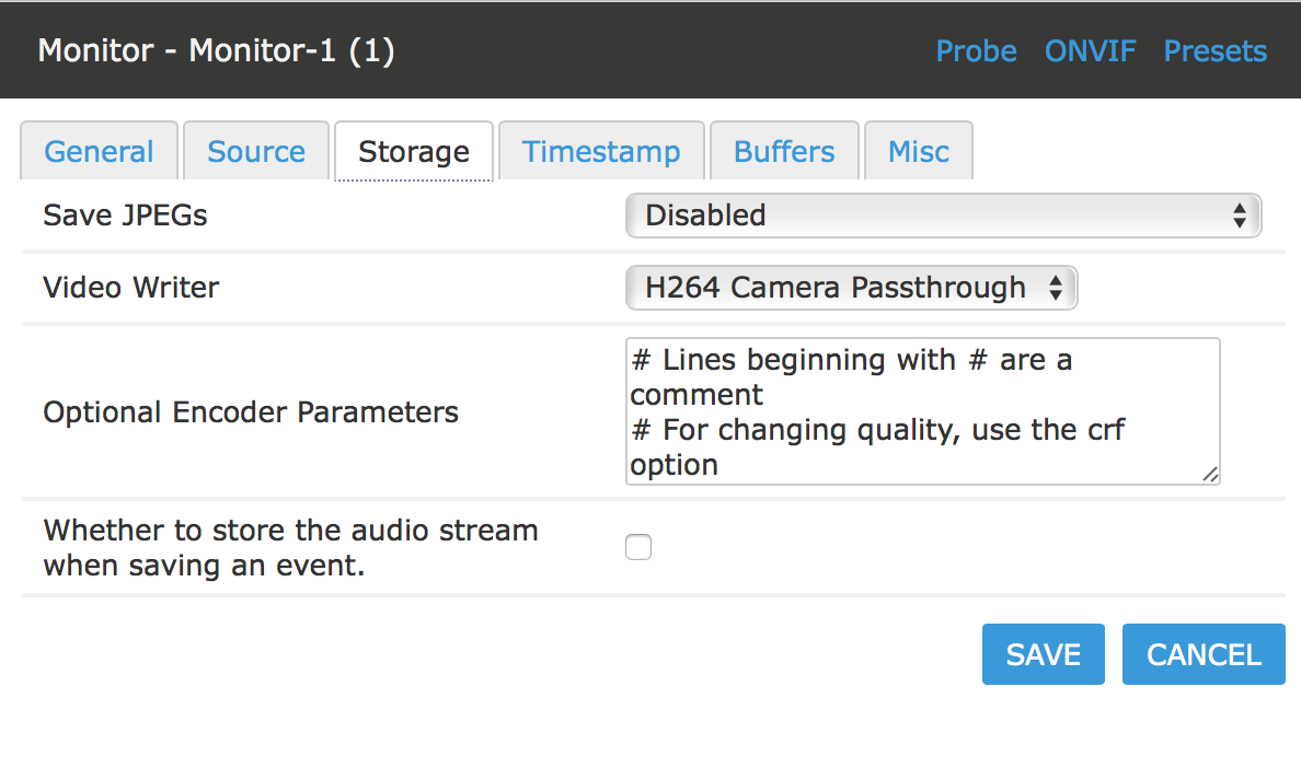

Using it
The branch adds a new Storage tab to monitor setup
Screen Shot 2016-07-31 at 8.59.05 AM.png (111.94 KiB) Viewed 31791 times
Save Jpegs
Decide whether or not to keep ZoneMinder's standard jpegs. Note: Currently we are still decoding h264 to enable the live streaming function of ZoneMinder.
Video Writer
Choose h264 Passthrough or h264 Encode, refer to What it Does above for which to choose.
Optional Encoder Parameters
For h264 Encode option you can play with the parameters
Whether to store the audio stream when saving an event.
Do that, but if you turn this on and start getting issues probably some problem with your stream, so turn it off again.
