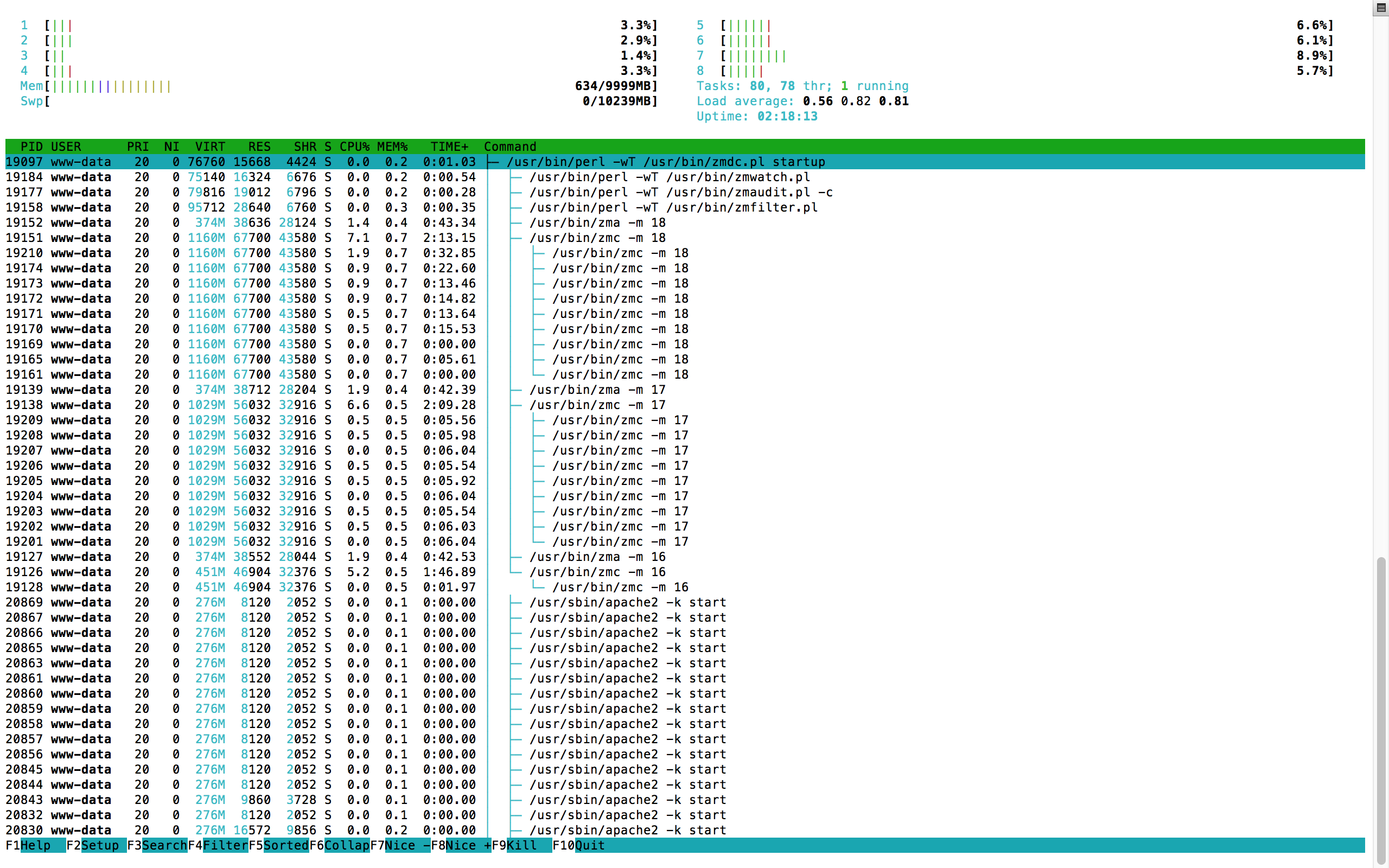

Thanks for the tip about the 32bit colorspace. I also tried libvlc, after reading your response and then installing the lib. I am able to stream using that option, also. Comparing the 3 different options, monitor 16 is set for remote, 17 is ffmpeg, and 18 is libvlc. All 3 monitors are using the same remote stream as the source.
Screen Shot 2016-03-28 at 8.06.50 PM.png (664.16 KiB) Viewed 11591 times
Monitor 18 seems to use the most cpu and memory, followed by monitor 17, and then monitor 16. I am curious why there would be multiple pids per process. I am not a linux expert, so maybe that is normal for the different.

kevin186 wrote:I am curious why there would be multiple pids per process. I am not a linux expert, so maybe that is normal for the different.
Just found out that is an htop thing, showing threads per process. Pressing shift h will hide the threads. But the cpu usage is still the same, of course. All 3 options appeared to have the same quality, but for efficient cpu usage: remote > ffmpeg > libvlc, on my system, atleast.
