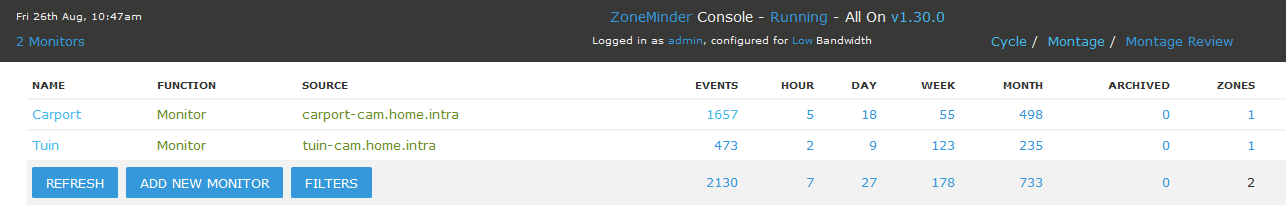

Modect stays active
Post by Mozart »
I upgrade to version 1.30.0 and came from 1.29.0.
On 1.29.0 I had no problems with changing my cams from monitor to modect and back.
With version 1.30.0 the cams stay on modect although the website shows monitor.
The logs show no clues for why this is happening. I tried to change the state of the cams multiple times between monitor and modect but it does not help. What can I do to get it working again?

I deleted the cams and created them again. I still have this problem. Even if the cams show as function ' Monitor' it does motion detection...

I changed the cams from source type remote to source type ffmpeg. Now they do stop detecting motion when they are on Monitor. Seems like a bug to me.

I thought that the workaround was to switch to ffmpeg as source but that does not solve the problem.
So I created a new Ubuntu 16.04 server and reinstalled Zoneminder with the easy setup steps on the wiki.
I still have the same problem on this mint system. The system detects motion even if the cams are on 'Monitor'.
Am I the only one with this problem?
How should I debug this?
