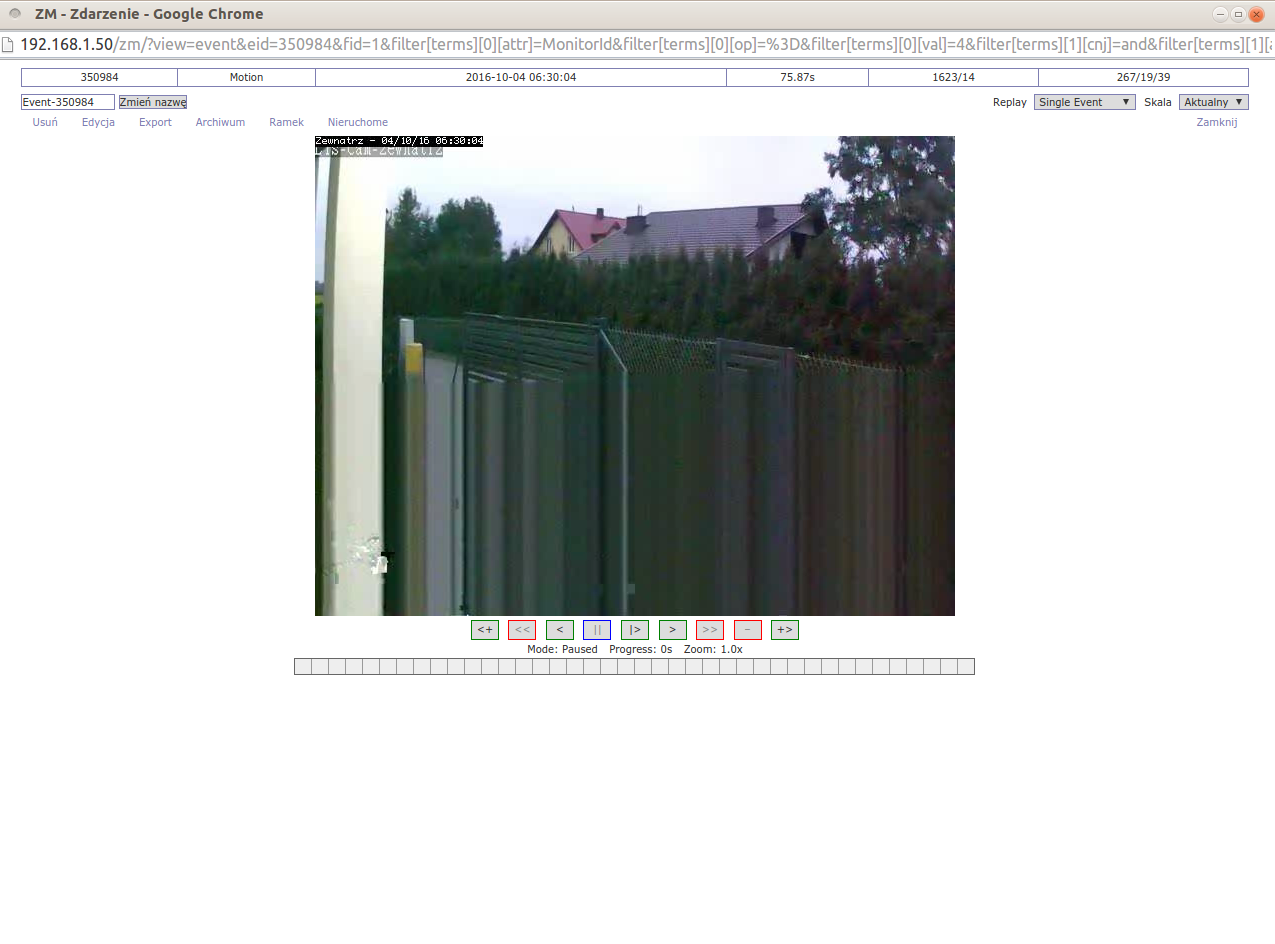

I am using Zoneminder 1.30.0 currently I have only one cam configured.
The problem is that the video image blures sometimes. It lasts few second and after this fuzzy period everything get backs to order with video image. This happens all the time, every few second/miutes.
The other problem - which might be linked to blures - the CAM keep recording all the time, however its set up as Modetect. I suppose those fuzzy frames triggers alarm ? Events lasts for 20 second and are continuous.

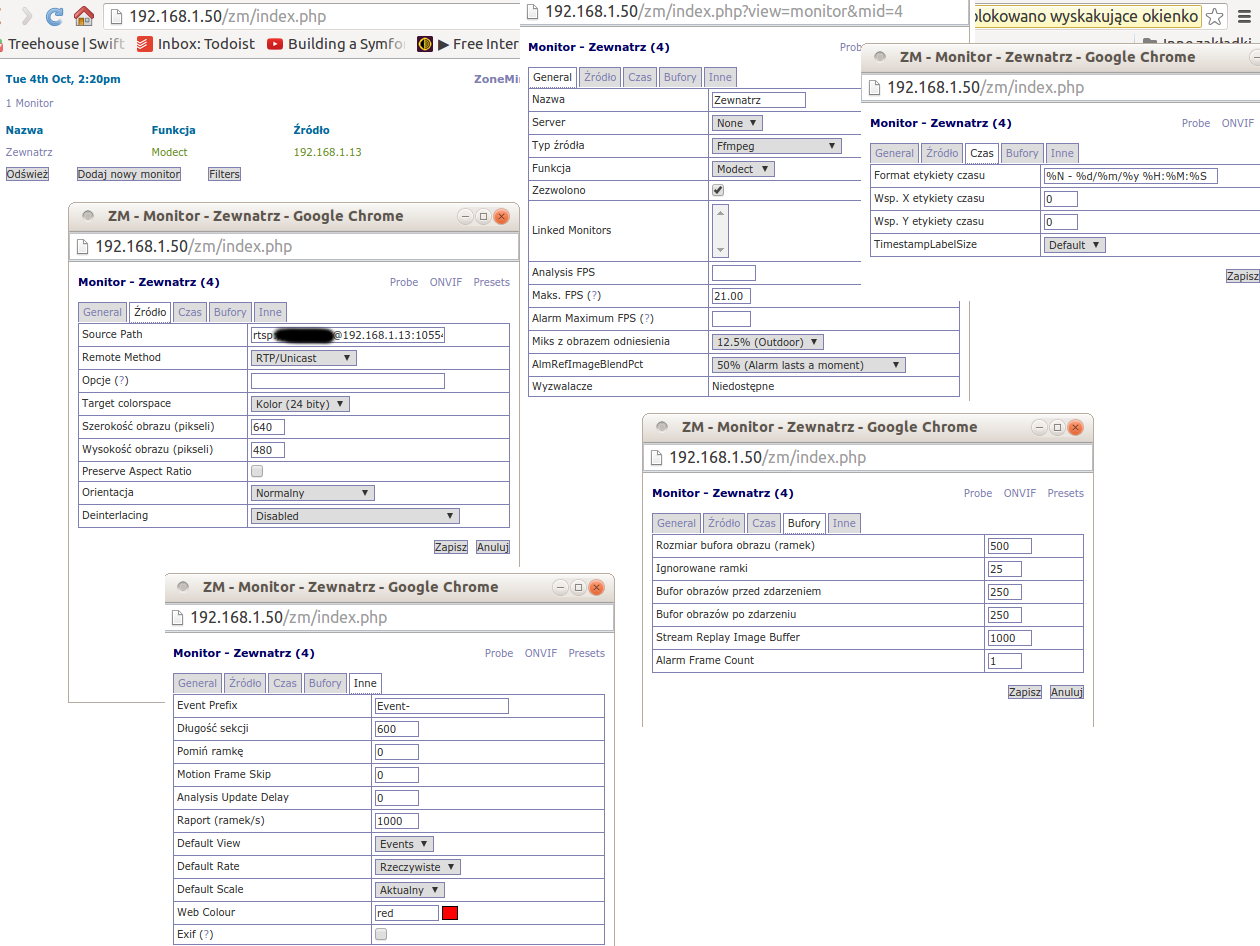

I attach a fuzzy frame and cam configuration in Zoneminder.

Search this forum for "smearing" and "streaking" -- this is a recurring theme. Yes, those horrid blurs will look like a big movement, and trigger MoDect into life.

Set MAX FPS to blank
Reference Image Blend %ge and AlmRefImageBlendPct to the same value (6.26% is OK to get started)
Slow the frame rate at the camera to 5 FPS and set the key frame interval to 5 or 10
Depending on the camera it may work better on the remote setting. Overmax looks like they are Foscam knock offs.
