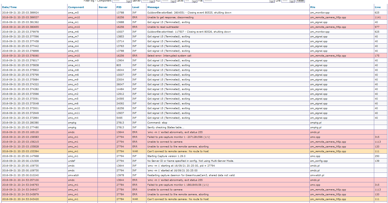

I've got a zoneminder setup on ~10 Foscam cameras that keeps shutting itself down. I can access the web interface and start it again and it works fine for a week or two but if I don't check it daily it obviously doesn't record video until restart. Only other user does not have administrative permission and cannot shutdown the system. I've attached snip of the log for reference, several of the cameras are intermittent so I get fairly constant connection failure messages :roll:

I can barely read the text in your screenshot, but those "No route to host" messages in your log mean zoneminder no longer has a tcpip connection to the camera. That is a network or camera problem.

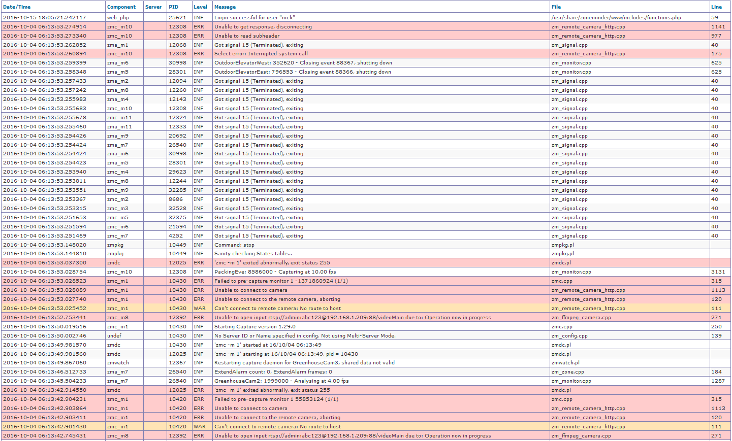

I've attached the newest log, appears very similar.
ZM Shutdown 101516.PNG (108.96 KiB) Viewed 6391 times
Re: ZoneMinder Periodic Self Shutdown
As before, those errors indicate a camera or network issue.
We need to see what was going on just prior to the errors occurring.
Instead of a single page screenshot, try pasting the contents of your log files under /var/log/zoneminder into a gist. You may have to enable that first under Options.
