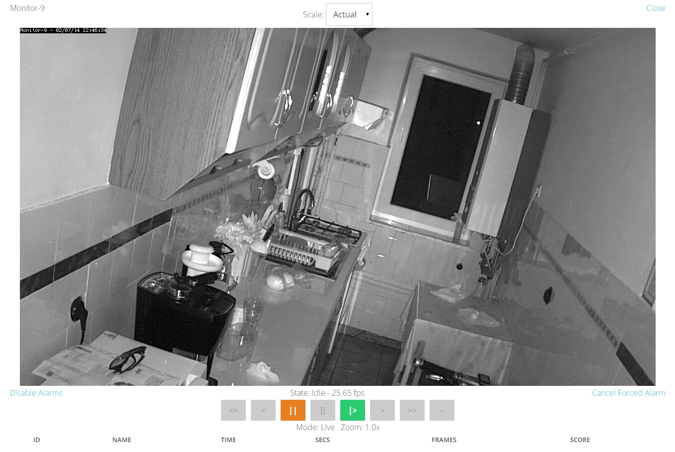

Hello, i don't know for sure if this is the right place but anyway...
I have bought this camera, don't mean to make any advertise ( http://www.dx.com/p/cotier-ipc-631-t13- ... 7Rfy_mSxg8 ) but i find it preatty cheap for an ip cammera with 720p resolution.
Anyway i have just set it up here are the settings :
soruce type : libvlc
rtsp://camera_ip:554/live/mpeg4
resolution 1280x720 24bit
also you have to disable authentication in network - mediastream setup
a snapshot in atached file.
please excuse my poor english.
10x
COTIER IPc-631/T13
COTIER IPc-631/T13
- snapshot.jpg (204.07 KiB) Viewed 13120 times

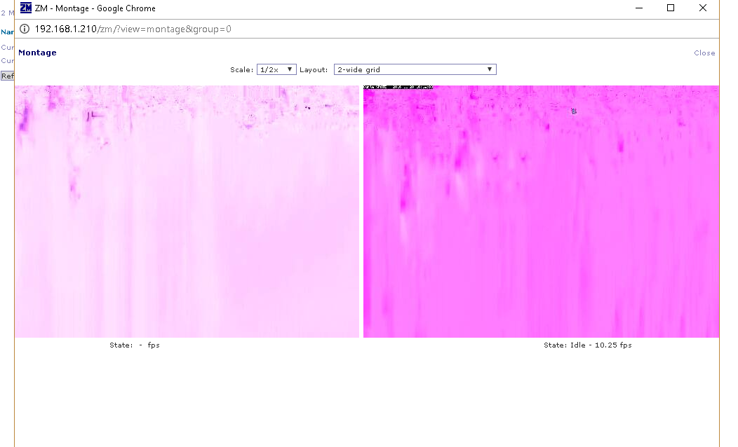

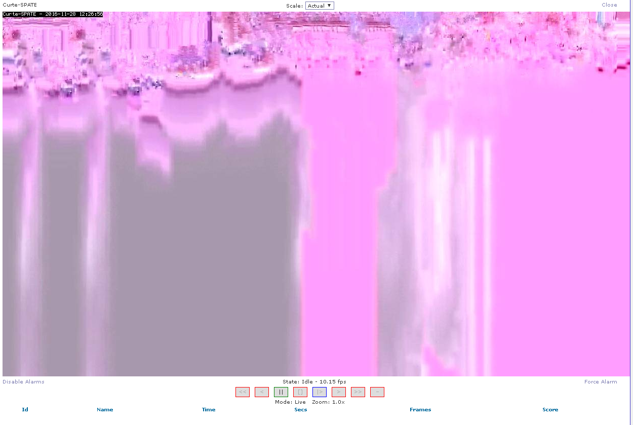

Re: COTIER IPc-631/T13
update... after some time this is what happens and i have no idea how to solve it for now
i am open for suggestions.
thanks
thanks
- Capture2.PNG (271.79 KiB) Viewed 10412 times
- Capture.PNG (720.22 KiB) Viewed 10412 times
well another update
it seems that if i set the camera on CBR ( constant bit rate ) and i frame key at 15 frames and running 15 fps no more pink rubbish on the stream.
all looks good so far.
