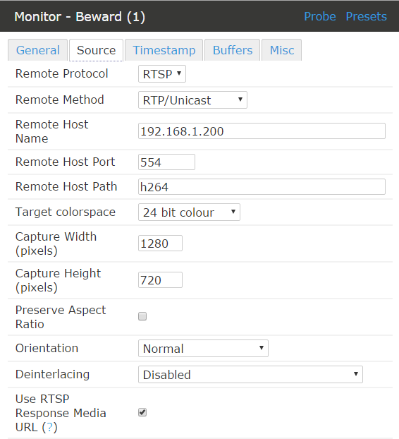

Hello guys!
Recently these warning have started appearing in ZM log:
Nov 29 06:04:38 server zmc[24856]: WAR [Packet in sequence, gap 68]
Nov 29 06:04:38 server zmc[24856]: WAR [Discarding frame 10684]
Nov 29 06:04:38 server zmc[24856]: WAR [Packet in sequence, gap 26]

...and so on. CPU load goes up to 2.00 and even beyond. Shorterly after this, ZM service may crash and won't restart (but may not, somehow). After restarting, it can happen again after 1-5 mins. Of course, there are no events recorded at this period. Crash log:

I'm running ZoneMinder 1.29.0 on Debian Wheezy, installed on Core2duo E8400 with DDRII 2 GB. Now, I have only one monitor - IP-camera (Beward BD4070) connect to LAN, which providing H264 720p25 video over RTP. I should say that problem started when I've raised bitrate in camera: from 4 Mbit/s to 8 Mbit/s. I wanted to get the maximum picture quality I could. Today, I've decreased it back to 4 Mbit/s, problem has gone but not completely. I've still have similar records in log:

I have only one question: what "Packet in sequence, gap N" and "Discarding partial, incomplete etc. frame" means? Why does it happen on a higher bitrate and even crashes zmc? I see a hard CPU overload but there is no out-of-memory, according to top or df -h /dev/shm. Is it ZM can not get in time nad handle all incoming frames? Network problem? But I've already sniffed and examined it, there are no retransmissions or packet loss. I've searched the Internet and this forum for this problem, but all topics are left unanswered. Can you at least give a clue, where to dig the problem? I'm a bit new to Zoneminder, however I've already loved it and don't want something other...
And here's my settings:
Re: "Discarding frame" and "Packet in sequence, gap N" floods the log
Change your source type to ffmpeg
