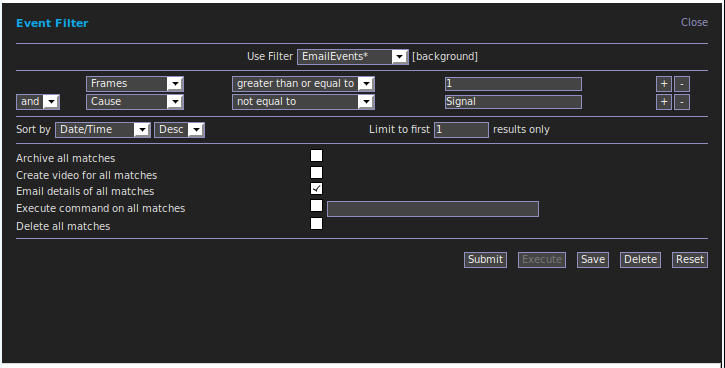

Re: Motion filter Email setup
this filter works for me and sends 1 email per event ->
Frames -> Greater than or equal to -> 1
and
Cause -> not equal to -> Signal #this prevents false alarm email because of a camera signal interruption. remove or create another filter to send email, if camera drops out and you want be notified with an email.
Date/Time -> Decending _> Limit to First= 1
