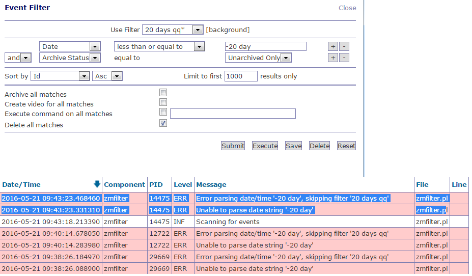

Hello!
I have a problem with zoneminder server filters.
Exactly, "Date/Time" filter has preset to "less than or equal to" with value of "-20 days". "Delete all matches" checked on. After "submit" command activation, all records (events) to be deleted are listed correctly, but "Execute" command activation results in nothing. All records (events) are untouched.
Log messages, applied to "filters" contain the following error messages "Error parsing date/time '-20 days', skipping filter '20 days qq'". The screenshots attached to this mail message.
Thanks in advance.
unnamed (1).png (11.78 KiB) Viewed 54770 times

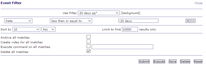

Re: Filters Date/time
Hope you can see the image of my purge filter

Error

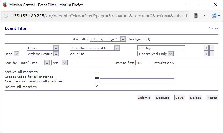

The only significant difference I see between mine and yours is that yours is set to "Date" and mine is set to "Date/Time". Mine works.
