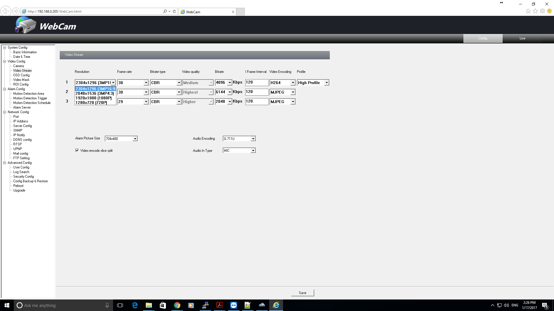

Hey Everyone
I am having Issues getting my Cameras to run Above 720p
The Camera is a truVue 3mp
I have been setting up using the add monitor then clicking ONVIF and selecting it from the drop down list.
It works perfectly fine on 720p in MPEG and H264
But if i select 1920x1080 i get artifacts on moving objects
and then if i go 2048x1536 i get distorted picture and the same with 2304x1296
Does anyone know how i can get this to operate in a mode higher then 720p?
Any advice on what to change or configure would be excellent.

Try RTP/RTSP instead of RTP/Unicast

hey guys sorry i thought i posted that.
Changing it to RTP/RTSP worked!
Thanks Heaps, i have noticed that the picture has a lot more grain to it than the original software is that normal for Zone minder?
This is awesome my camera is finally running at what it should!!! Now i just have to fix the videos not displaying in the Gui and i am set!
