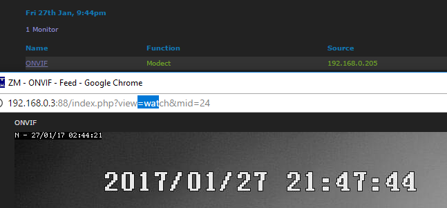

I finally have set up all my camera's and got everything working awesome!.
The only issue i am having is my timezone is not showing correctly on my cameras.

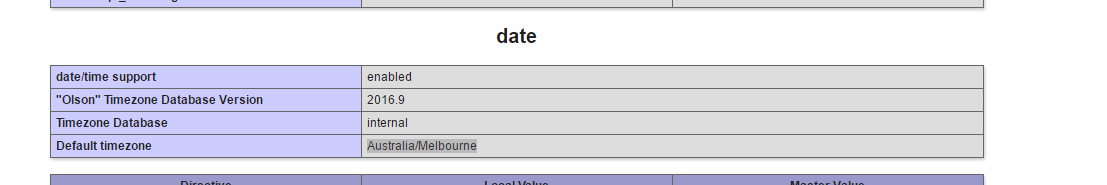

I have updated my php.ini file would Australia/Melbourne
As you can see ZM main page displays the correct time but on the camera it is showing the wrong timezone.
I also created a small php page to echo the time and it returned correct.
So this date must come from another source.
Does anyone have any idea where it comes from?

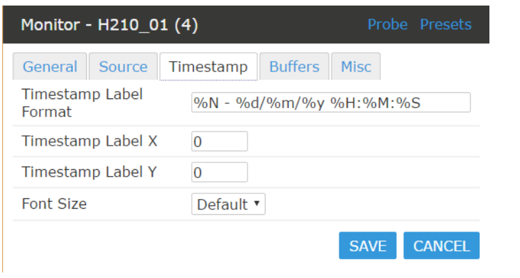

I think you have to set it in each camera setting
- 8.png (64.38 KiB) Viewed 4568 times

Double check actual server timezone and time, the video timestamp is done in c++. Same TZ as me.
