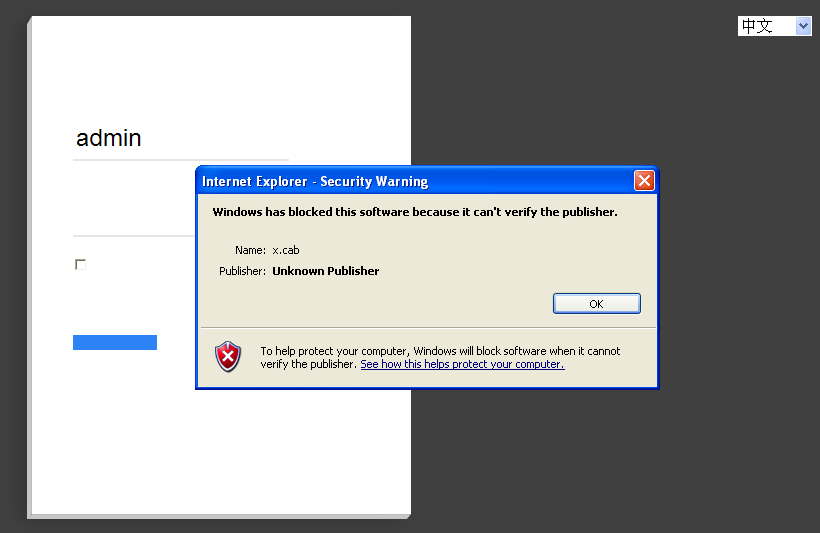

I did look into changing my camera's FPS BUT the system's firmware is requiring me to down load an active x file called x[dot]cab and to be honest I am a little hesitant to do this. I read the camera does 30 FPS normally and I may let the system go as is if it continues to run OK at least for now.

- unknown.PNG (24.3 KiB) Viewed 1498 times
