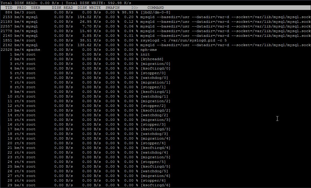

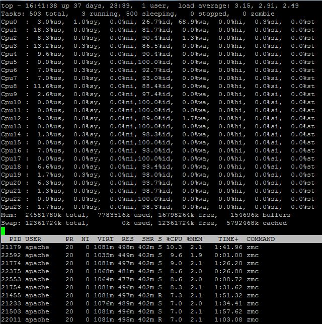

I finally got around to configuring my POE system using ZoneMinder. I currently have 14 POE cameras online with zoneminder running at 1920x1080 32bit color @ 5FPS. The problem I'm running into is I'm getting about 70+ log entries every second in ZoneMinder (see below), montage is not loading more than 5-6 cameras and the ones that do, are snowy (almost like the pepper static from old tv's). When I view a monitor directly, it looks perfectly fine and works without problem. The system is jumping between 30% and 60% iowait (Using a WD Purple 4Tb).
I am new to Zoneminder and camera systems in general so I don't know all these little tricks/tweaks to get things working properly.
Anyone have any suggestions on what I could try?

IOTop output
IOTop output

Top output
Top output

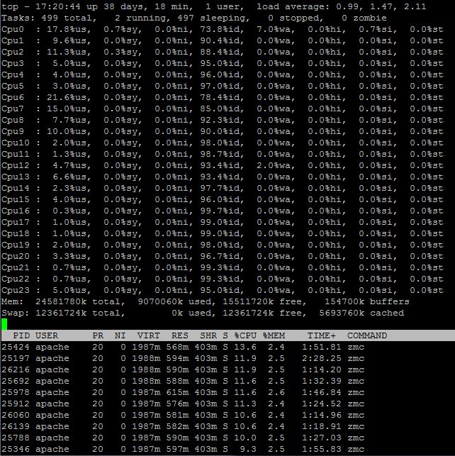

You nailed it. I updated all of the cameras to FFMPEG and the usage is like night and day. I'm still getting some bugs in the images, but it mostly seems to be coming from the montage. I will just probably use a different browser for viewing in the future. I appreciate your help.
top after switch to ffmpeg
