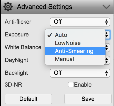

I turned off "3D-NR" on the 3 cameras that have had the smearing issue to see if that's related. I've also read it could be something with the h264 profile (I have the cameras all at high, but there are main and baseline options too). Also there's a contrast option "anti-smearing" that is interesting... I just don't want to sacrifice image quality.
Funny, I've been reading about the Reolinks on other sites (Blue Iris mostly) and some people call them junk. I have a few Avigilon and Amcrest cameras and I think the Reolinks are just as good if not better for the money. Of course time will tell with firmware updates, support, and their longevity being outside, but we'll see. I could spend $200-$300+ on a camera ... but why? :)
See advanced options on the Reolink for grins:
Screen Shot 2017-03-21 at 12.09.08 AM.png (69.99 KiB) Viewed 24145 times
jt

I should have mentioned it. I also played with "exposure". "Low-noise" allows gain changes, "anti-smearing" allows shutter changes, and manual is both. I think they are both upstream of the encoding like the rest of the image settings so I don't expect they would have any effect.
