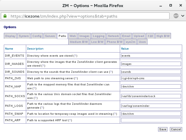

I guess I messed something up in the paths, but I really thought any of the changes I've done recently were reverted when it didn't react the way I thought it would.
Does anything look obviously wrong with the paths here:
asker
Posts: 1553
Re: zmNinja for desktops
Post by asker »
You need to go through the link I posted above, especially if you are on ubuntu. Chances are you did not read the cgi-bin apache instructions.

asker wrote:You need to go through the link I posted above, especially if you are on ubuntu. Chances are you did not read the cgi-bin apache instructions.
I'm running on SciLinux 7.1. Checked /etc/httpd/conf.d/zoneminder.conf and found
ScriptAlias /cgi-bin-zm "/usr/libexec/zoneminder/cgi-bin"
Tweaked everything and the desktop app is mostly working now. All the monitors are good for live viewing. But when I try to watch a recorded event I get the camera icon with the big question mark. Using the web interface event viewing works.
