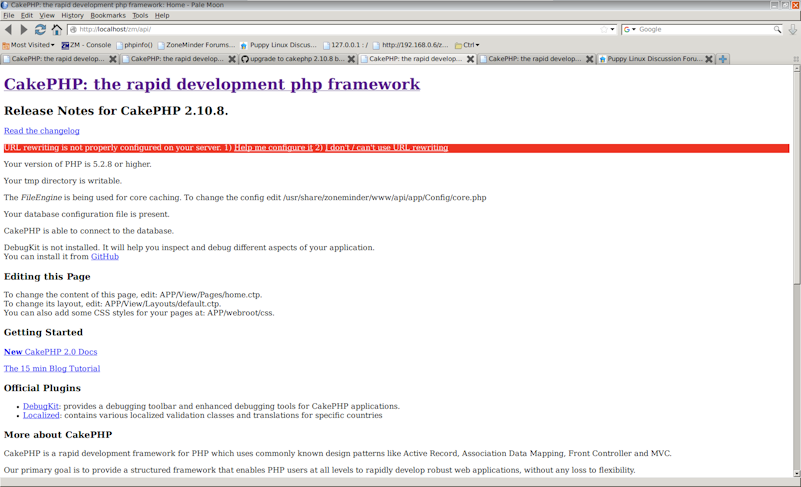

I do realize that version 3+ was going to fail. I am managed to get this page..but no css for some reason....
Re: API not working with PHP 7.2
Huh, I'm struggling to read the text in that screenshot, and I'm remembering what the eye doctor told me last week when I went in to get another year of contacts. I'm in the age group where my vision will start to change. Oh joy.
The stuff in red... URL Rewriting... that's an Apache configuration error. That's an issue either with the .htaccess files mentioned earlier, or you've got a global command overriding them. Hope that helps.
thanks for the suggestion....you can ignore the URL re-write warning.....I am using Hiawatha instead of Apache...and the re-write looks like this:
UrlToolkit {
  ToolkitID = api_rule
  Match ^/zm/api Rewrite  /zm/api/app/webroot/index.php$1
then applied in the virtual host block:
VirtualHost {
Hostname = 192.168.0.*
WebsiteRoot = /var/www/hiawatha
StartFile = index.php
AccessLogfile = /var/log/access_log
ErrorLogfile = /var/log/error_log
TimeForCGI = 3600
ShowIndex = yes
ExecuteCGI = yes
FollowSymlinks = yes
#    UseFastCGI = PHP5
#    TriggerOnCGIstatus = yes
NoExtensionAs = cgi
EnablePathInfo = yes
#    Alias = /cgi-bin:/usr/local/libexec/zoneminder/cgi-bin
Alias = /cgi-bin:/usr/lib/zoneminder/cgi-bin
Alias = /zm:/usr/share/zoneminder/www
Alias = /phpmyadmin:/usr/share/phpmyadmin
UseLocalConfig = yes
UseToolkit = api_rule
but that leads to me think I need to try this all with a Bionic running Apache2 PHP 7.2 MariaDB..... I don't see that being the reason since every other version using Hiawatha and the URL re-writes it uses works really well.......but to eliminate the possibility and when I find the fix it should be for an Apache - ZM setup since the majority of the users of ZM run this configuration and who knows? maybe jar something into place or expose what is breaking the API

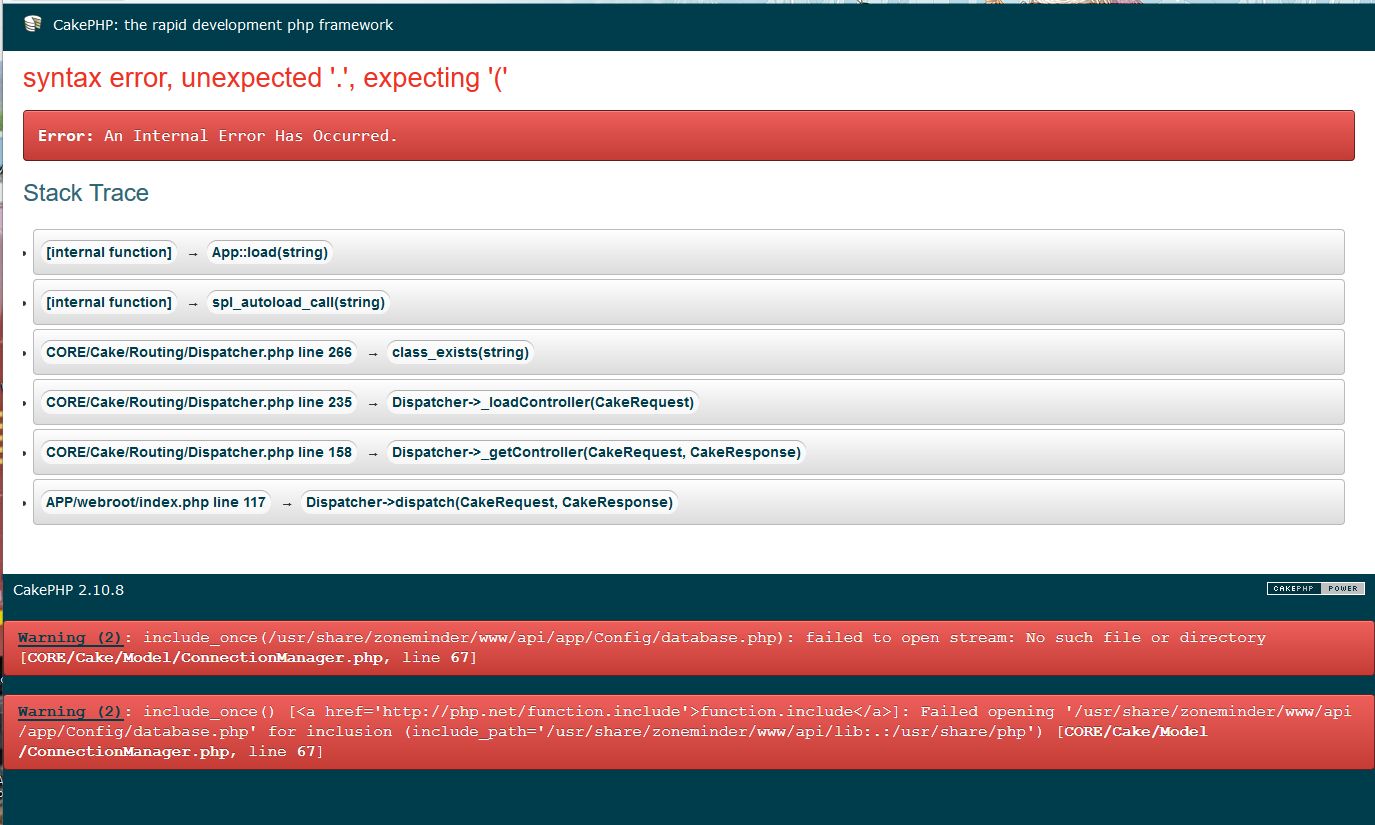

http://192.168.50.2/zm/api/host/getVersion.json told me I needed to create http://192.168.50.2/zm/api/app/Controll ... roller.php withe the contents:
<?php
class HostController extends AppController {
public function getVersion.json() {
Now http://192.168.50.2/zm/api/host/getVersion.json shows this:
In the zoneminder /api folder is /api/app. And inside /api/app/Controller there are the controllers code files that do the connections and functions with zoneminder like /api/app/Controller/HostController.php
Also in /api/app/Models are files that need to be present for the interaction with ZM.
Important are the /api/app/Config files dataase.php, core.php, bootstrap.php these load functions and set where to find the ZM config files needed to make the database connections.
There are other custom bootstrap.php files also needed.....
Right now I am adding just enough for /api/app/COntroller/HostController.php to function program by program.
Look in the /api/app folder on a working API to see what files are needed. I must be missing some small detail.
