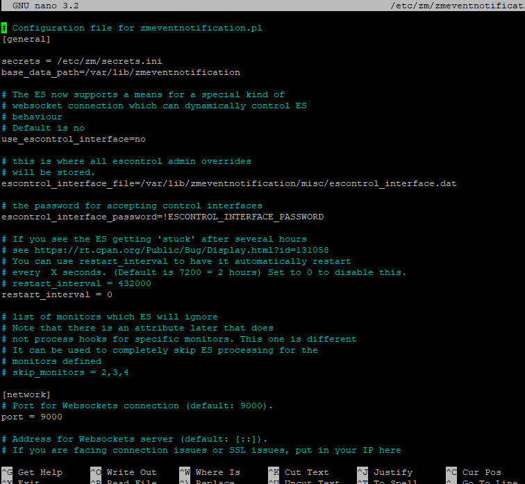

then on the tutorial followed I had to set the parameter in
cd /etc/zm
nano zmeventnotification.ini
it's always up to date

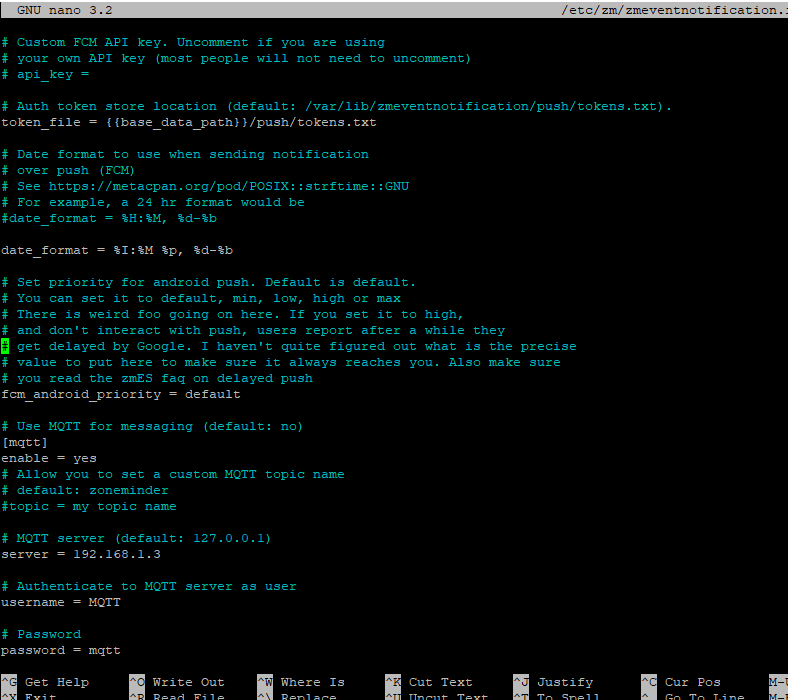

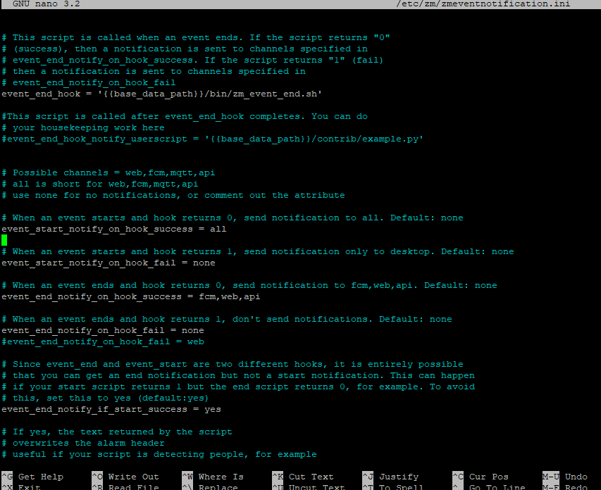

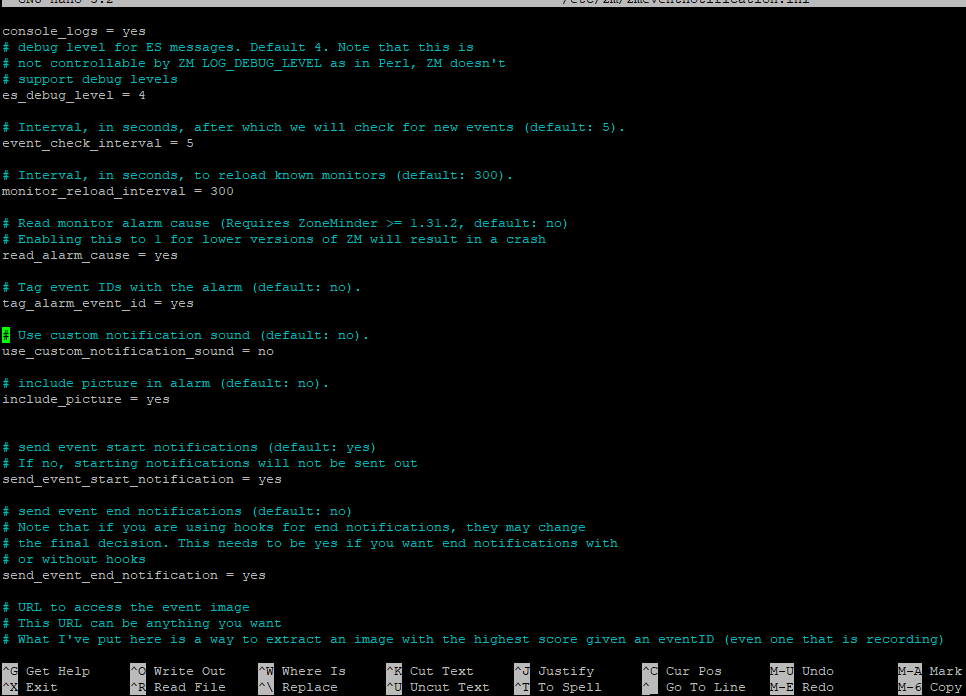

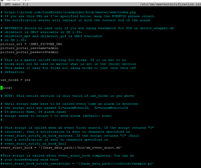

I also put you my configuration of zmeventnotification.ini

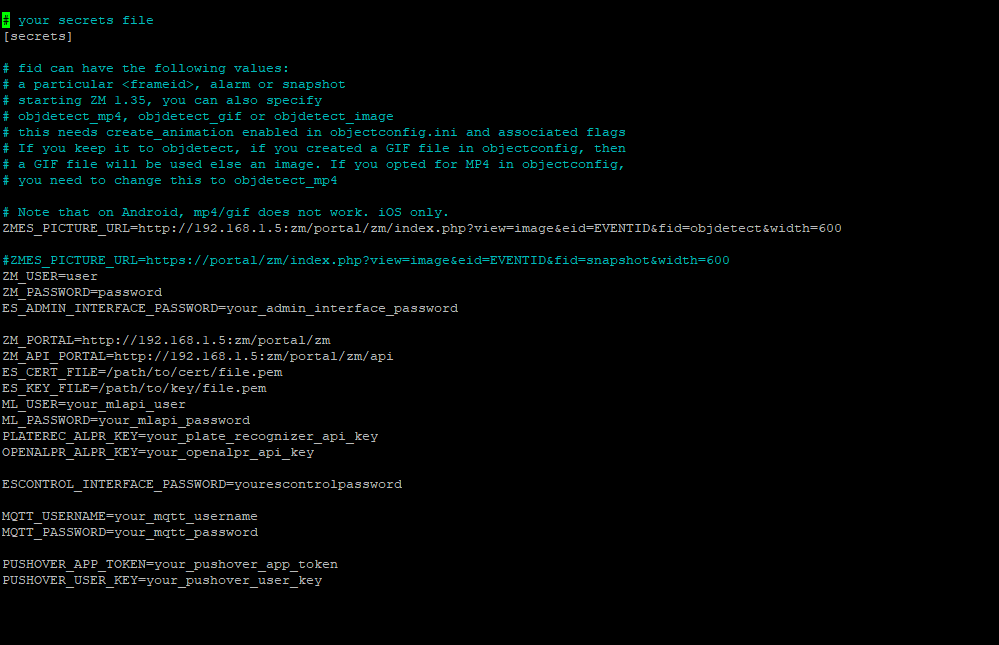

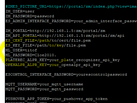

You have a typo in your secrets.ini file in your PICTURE line. There's a : where a / should be after your IP address.

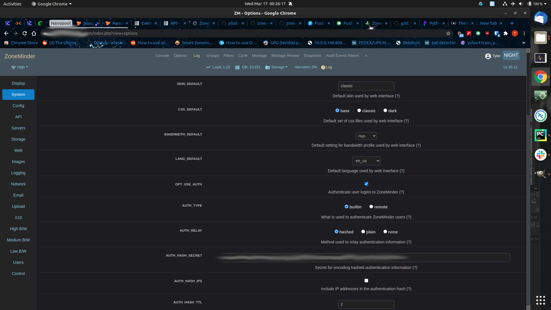

Here is a picture of what I mean for the options. Where it has the big blur, you need to input a random string to use for hashing, doesnt matter what it is. Also are your ports forwarded for the websockets so that the ES can talk to zmNinja? port 9000 is default in the configs if your using zmNinja mobile. You can test using zmNinja on desktop on local network for now I think. IDK if pictures will work but you should at least get a desktop app notification?

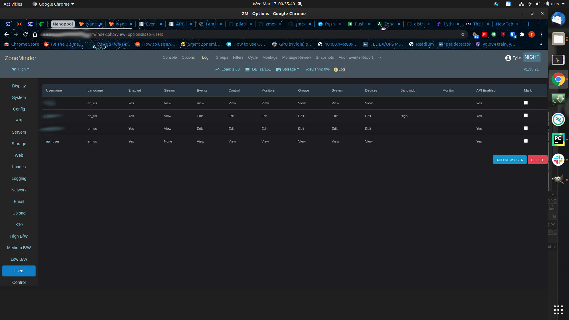

You also need to create a user and password for the ES to talk with zoneminder API's in the zoneminder webgui. Here is a picture of that screen it is in "Options > Users". I have "api_user" setup just for the ES. You could use the "admin" account but I think its good practice to create a regular account. Once you have the user and password created you need to place those in secrets.ini.
Did you follow the readthedocs and install the Perl modules needed? numpy, pillow and all that stuff for python? OpenCV and OpenCV contrib 4.3+ ?
Let me know if this is hard to understand and ill try and use google translate.

tsp84 wrote: Wed Mar 17, 2021 6:06 am You have a typo in your secrets.ini file in your PICTURE line. There's a : where a / should be after your IP address.
Did you follow the docs and setup auth in zoneminder options with a hash passphrase and append IP off? Are those credentials correct for a user you created in the zoneminder options and that that user has access to the API?
Are you talking about this line ZMES_PICTURE_URL = http: //192.168.1.5: zm / portal / zm / index.php? view = image & eid = EVENTID & fid = objdetect & width = 600
no ip is http://192.168.1.5:zm to have zoneminder

I just made a user and I put it in secret.ini
c'est bon.PNG (21.65 KiB) Viewed 18663 times
something else the ip of zm replaces in secret.ini the words portal?

You have a few typos in your secrets.ini file
ZM_PORTAL=http://192.168.1.5:zm/portal/zm
should be
ZM_PORTAL=http://192.168.1.5/zm
ZM_API_PORTAL=http://192.168.1.5/zm/api
I see in your zmeventnotification.ini that you have ssl enabled and certs set up with the default settings;
[ssl]
enable = yes
cert = /etc/zm/apache2/ssl/zoneminder.crt
key = /etc/zm/apache2/ssl/zoneminder.key
Did you get ssl certs and name them like that and place them in your /etc/apache2/ssl/ dir? If not, you need to get LetsEncrypt certs or make some self signed ones. If you do have those certs set up and working you should also use those for ES. To check if you have those certs copy and paste the output of
ls -al /etc/apache2/ssl
