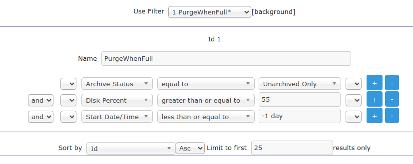

1) zmc crashes are VERY bad... the camera "Maximum Image Buffer Size" setting has been the root cause of zmc crashing. I had to set my 720p cam to 5000 and my 1080p cams to 8000. That stopped the errors about the queue being full and then the imminente process crash that would occur. Once that happens, you don't get an end stamp on that segment and the purgewhenfull filter as written, will randomly delete events. I still had two oom events kill a zmc but they don't appear to have effected much. In the last 24 hours I think I've had less than 10 events without end stamps but doing that query sometimes blow up the load, which bring me to my next point...
2) event lookup... anything over 100 events was blowing up my system load (which is known problem that I heard will be fixed in .26) and results in needing to restart apache2 to drop the load so the system is usable. I typically can view and hours worth of events but day sometimes is and a month definitely is a no go. This made it hard to troubleshoot why the purgewhenfull filter was not working but I've found a "fix" for that...
...if you look at that last line, instead of the default, I use "and Start Date/Time less than or equal to -1 day". That was the main thing that got this working. Limiting to 25 events then also prevents the system load from blowing up as a result of the SQL query.

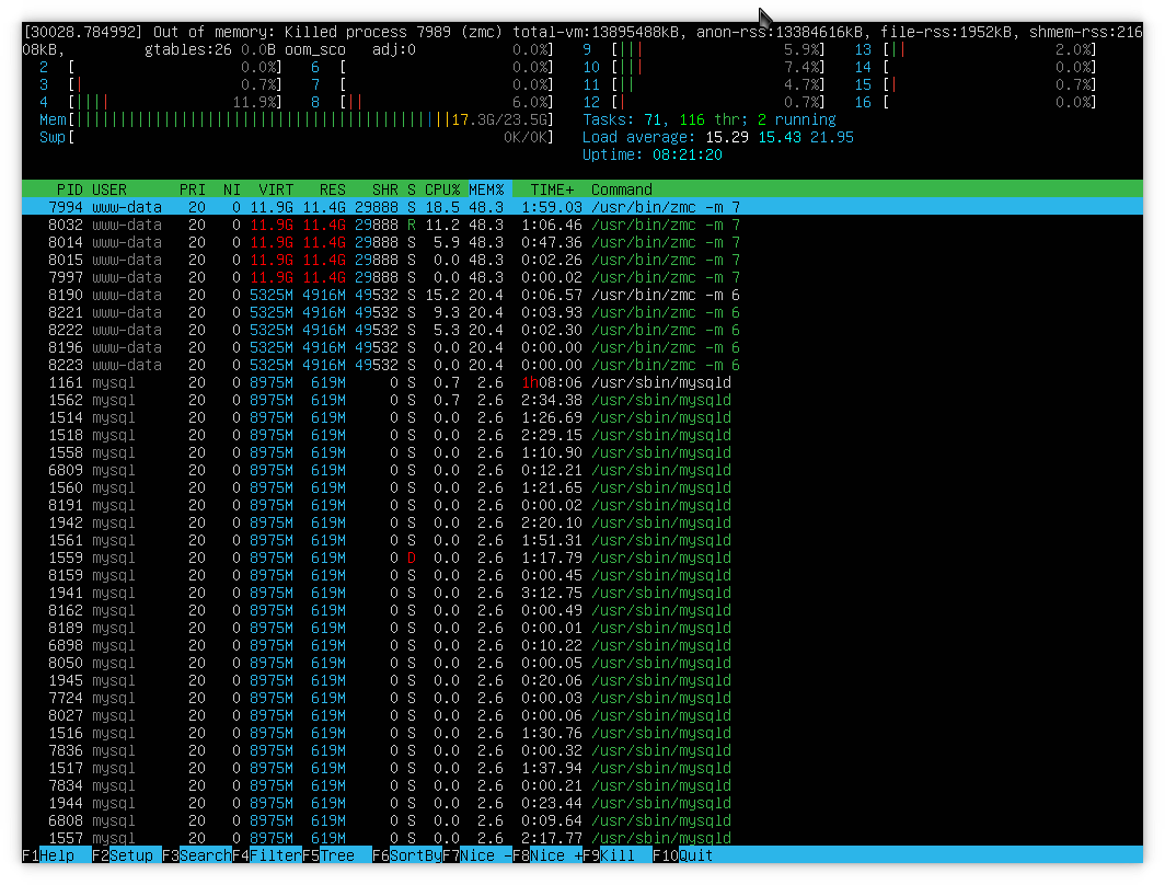

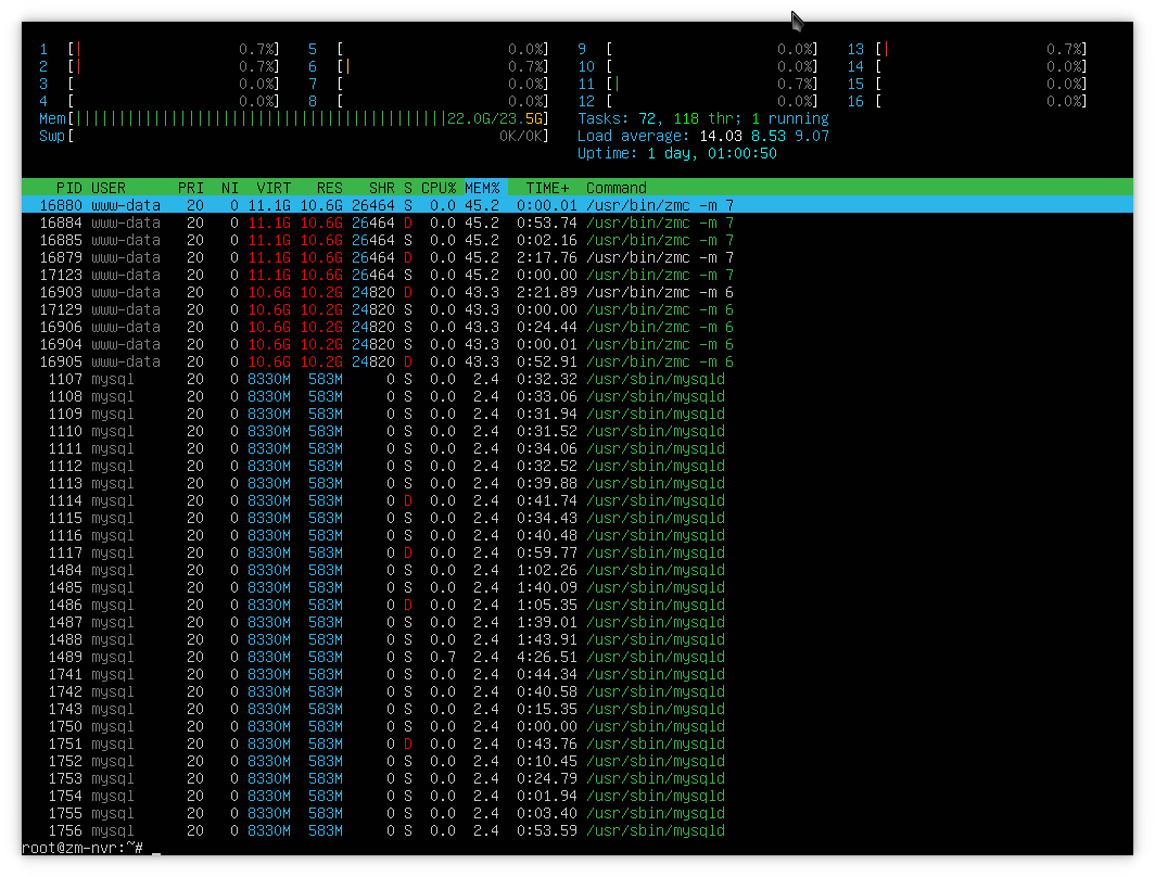

I think I may have spoken too soon. A zmc memory leaks appears to be back. This was yesterday...
I turned off the disk purge routine since I thought it might be that but now this is front today...
Posts: 3391
Re: Released 1.36.25 The Memory Remains
They are all in D state... waiting on disks... likely...

iconnor wrote: Wed Sep 14, 2022 2:07 pm They are all in D state... waiting on disks... likely...
If something gets slow, the queues fill up. Which is why we have MaxImageBuffers...
Interesting... so when the "queue" fills up is that why I'm seeing the process consuming so much memory? Something that comes to mind with MaxImageBuffers is that I've had to turn them up very high to stop getting the messages about the queue being full. That's all fine except that that number based on calculated max ram use is greater than the system memory so in my case oversubscribing appears to be causing the oom to kick in because I'm actually passing a physical limit. The thing I don't understand now, if this is about disk access, why am I seeing this conditions more now in.36.x?
After my last post, I when back to record mode for all cameras and turned off analysis. I also turned back on the purge process. Initially that was great but then the the same issue came back in a couple of hours. Cameras go down every so often saying unable to stream or camera is not connected. I won't see any queue errors in syslog but I will see oom killing a zmc process.
