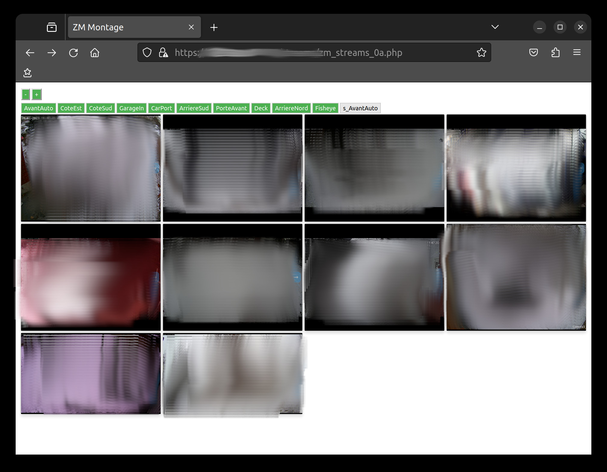

Hello
I uploaded a php file to github called "zm_streams_0a.php" for those interested. Works great on browser and phone. (There is also a script for object detection but they are both independent of each other.)
https://github.com/lbdc/zm-alarm
I have been using this for viewing my cameras. Gets the camera links directly from the database so only have to provide username and password of zoneminder.
Functionality:
- Display streams
- Resize grid
- Automatically adjust columns based on page width and grid size
- Reorder grid by drag and drop of buttons
- Automatically adjusts for aspect ratio, keeping grid consistent
See github readme for details.
This is not production code but is functional.
