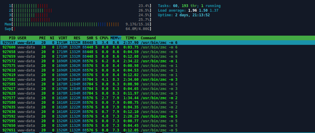

I'm seeing the same issue on a system that's basically remained the same (in terms of camera and configuration) for a couple of years.
I'm currently running 1.37.50~20240129103951-jammy, and I can't really tell with which release it started happening, but server memory is slowly eaten up, moving onto swap being exhausted until there's an eventual OOM auto kill of zmc.
You can actually watch it happening in real time in htop, it's quite quick:
htop rising emory
htop rising emory
Nothing of note in the default log output.
Posts: 3361
Re: The memory fills progressively
Hey, are people who are experiencing this using Decoding=OnDemand?
I think I found the problem, and it's because Analysis is waiting for decode and so capture thread is just filling up the queue.
new package building should fix this.
c128
Posts: 88
Joined: Sat Sep 14, 2013 3:36 pm
Post by c128 »
iconnor wrote: Tue Jan 30, 2024 2:41 pm Hey, are people who are experiencing this using Decoding=OnDemand?
I am :) - thanks, will check out the new build when it's available.

c128
Posts: 88
Post by c128 »
Well, it seems to have worked for me.
I upgraded to 1.37.50~20240130093217-jammy a couple of hours ago, and memory usage has stayed pretty constant since.
