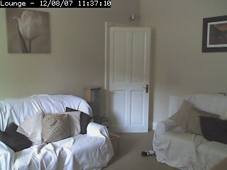

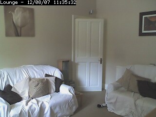

Okay, here you go...
(Server restarted and run first using snapshotjpeg (error-free) and then nphmotionjpeg, for which errors occured every couple of minutes):
snapshotjpeg:
nphmotionjpeg:
For what it's worth, the frame rate of my IP cameras cannot be throttled at the cameras so whilst capturing at 3fps in nphmotionjpeg mode there are presumably surplus frames also arriving.
