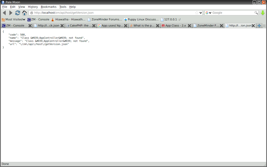

I got the API to work somewhat.......very promising the return gave me
    "code": 500,
    "name": "Class 'AppController' not found",
    "message": "Class 'AppController' not found",
    "url": "\/zm\/api\/host\/getVersion.json"

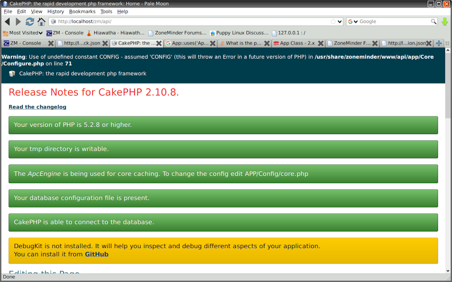

Using cakephp 2.10.8 and Crud 3.0.10 ( the first version compatible with PHP 7 +) there are a lot of little shortcuts and temp modifications like lines being added and others commented out....as soon as I hammer out this last hurdle of an error(s) I will have to clean it up and try to duplicate it so I can actually add the fix in a less chaotic way....there are all kinds of odd mixing going on but it almost works again.
Re: API not working with PHP 7.2
except for a nagging minor error I have the API running....somewhat!
