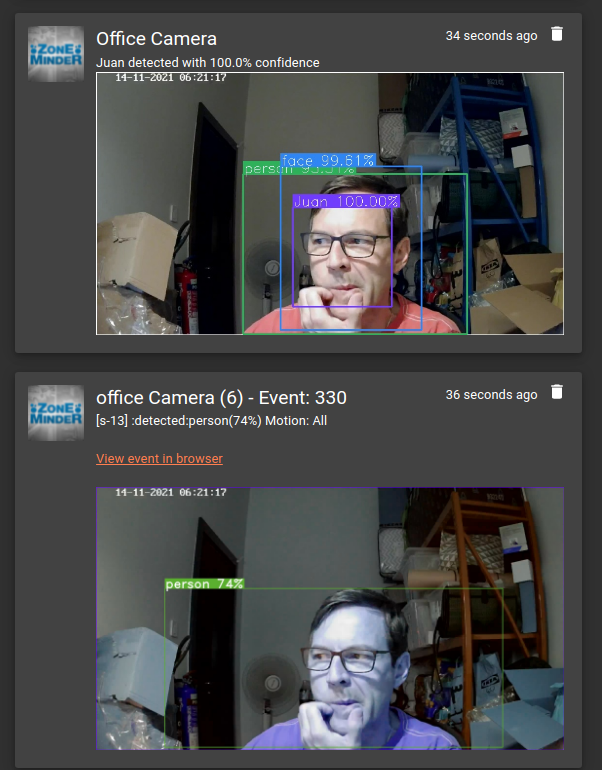

My image seems to be correct now. zmevent is running, created mlapi user and mlapi is running, but object detection is not working.
If you have a chance you can maybe give my image a spin. I created one at >>

EDIT:
never mind. also traced the error to leaving uncommented your example for ZM_ML_USER/PASS IN zm_secrets.yml.
I commented it out and it all now runs without error.

small question, do you know why the picture in the neo gotify message (bottom snap) has (off) colours when compared to the standard gotify message?
tsp84
Posts: 227
Re: neo-ZMES - Public Beta
Post by tsp84 »
Ok so someone else has it happen too. It's weird because it was working fine and then I noticed I was getting BGar colored frames too. It's an easy fix I'll do here right away.
Edit: the really weird thing is it would happen 8n gotify web app and when I refreshed they were proper color so I wasn't sure what was the culprit.
