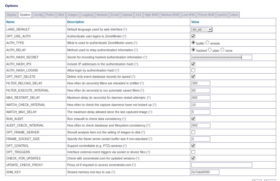

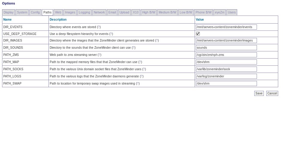

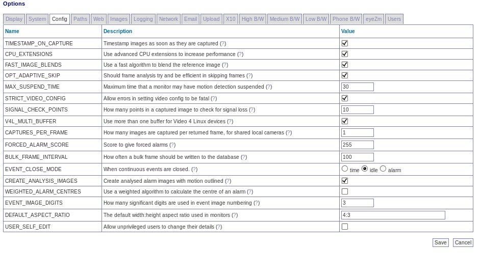

Re: Zoneminder RPM & SRPMS for Red Hat & CentOS 6
I went ahead and reinstalled ZM and a new database.
It must be an option of some sort creating problems because right after installation and database configuration, I went to the ZM webinterface, added my camera source in a monitor, immediately the source came up green and live stream worked.
Then I decided to configure the options and it crapped. Now I am back to square one. I really did not change many options, pretty much only the path where I want to store the events & images (on my freenas box), logging options and email settings....
Attached are screenshots of my options. Take a look and let me know if you see anything that could/would cause such issues...
- zm3.jpeg (76.08 KiB) Viewed 11590 times
- zm2.jpeg (109.87 KiB) Viewed 11590 times
- zm1.jpeg (137.24 KiB) Viewed 11590 times
