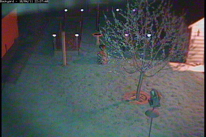

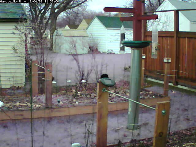

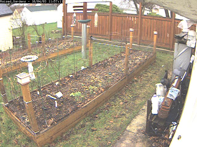

Take a look at these two images. One is from a TrendNET TV-IP512P camera and the other is from a ACTi ACM-3601 camera, both are network cameras both delivering MPEG4 at 30fps. Both pictures are of the same area of my backyard. Note the purple grass in the picture from the TrendNET camera as opposed to the green grass in the picture from the ACTi camera. I would say the TrendNET has a problem with Hue and there is no adjustment for Hue on the camera. There is an adjustment for Saturation but that doesn't help. And its granularity is in 25% steps, also not real helpful. I would like this Hue problem corrected and have contacted TrendNET regarding this so hopefully then can and will address this. I will update this with any outcome. Otherwise the camera is somewhat of a disappointment IMO.

The wrong hue in the picture from the TrendNet camera is definately caused by it being sensitive to IR light during the day. The Acti has an IR cut filter to stop this annoying effect.
For day / night function you should look for "true day night" or "switching IR filter", and Acti is a much nicer brand than TrendNet from what I've read. This TrendNet's colours seem so inaccurate that you'd have difficulty being sure of a suspects clothes color.

That is definitely the IR sensitivity. Before you return it, though...
I've modified my Trendnet cameras to be IR sensitive by removing the IR filter. This has the effect of purple grass and odd colors, exactly like you are seeing. However, the IR sensitivity is awesome without the filter. It's better than many, many other IR camera's I've seen and used. Even a little IR LED pen light will light up an entire area. A small IR flood will make everything visible for over 30 feet with the filter off.
So... sacrificing color for exceptional IR sensitivity was a good trade off in my book, but that may not be for you.
BTW, I have multiple Y-Cam Black cameras, also IR. Some exhibit the "purple grass and pink trees" behavior, some don't. Both type work fine at night. My guess is some versions of this camera have adjustment, and newer boxes even come with a warning sticker on the inner box saying "Colours may not be accurate because of the IR" so people have been complaining

Not necessarily true. That Smart Home IR camera I have (image shown above) does not have the purple grass problem.
