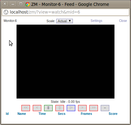

For this camera guvcview works perfectly. xawtv comes up immediately showing video. The device shows as supported over at the UVC support page at "ideasonboard".
With ZoneMinder I get a red device name and (at best) a black video square.

With those settings I get a black square.
The camera was purchased in the USA, but NTSC does the same.
Black square using v4l2, YUYV, 320x240, PAL.

Curiously:
# zmc -d /dev/video0
Results in video, right in the same browser window that had black before! It captures about 1fps, or maybe a little less (half a frame per second). Though, the events look pretty messed up
