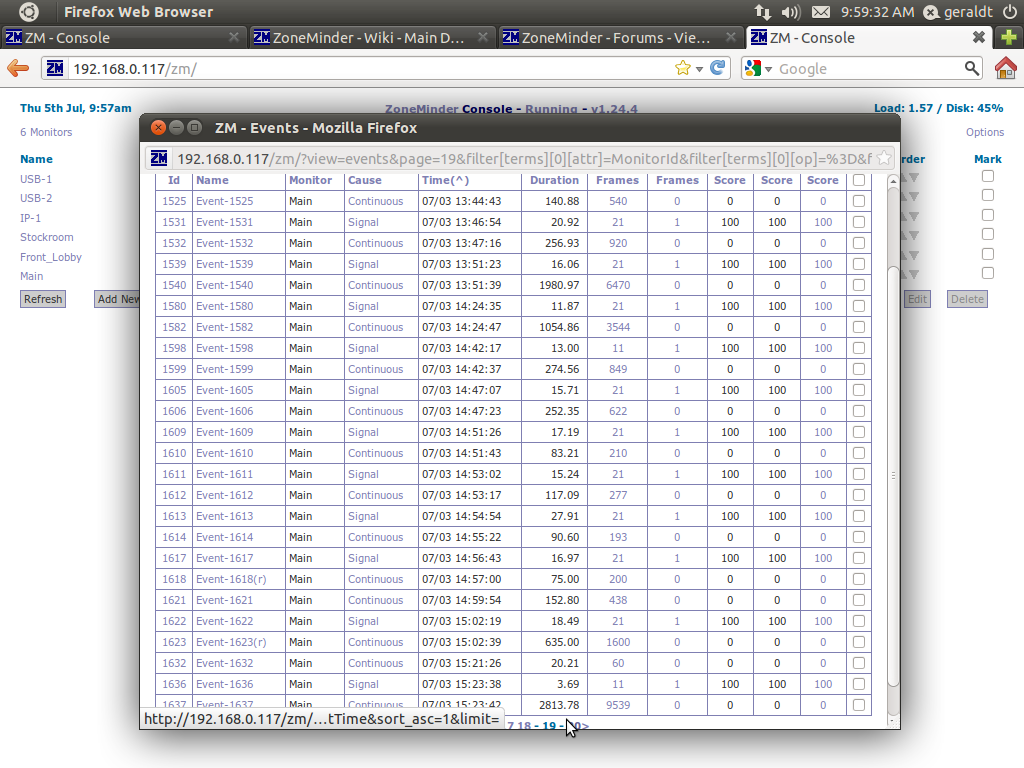

and it returns 4096 (4 kB) for my block size. This means my max file size is around 16tB, right? But my IP cameras still create those Signal Events. I have tried some local USB webcams before and they could record for 1 whole day without any cuts. How can I do the same for my IP cameras?

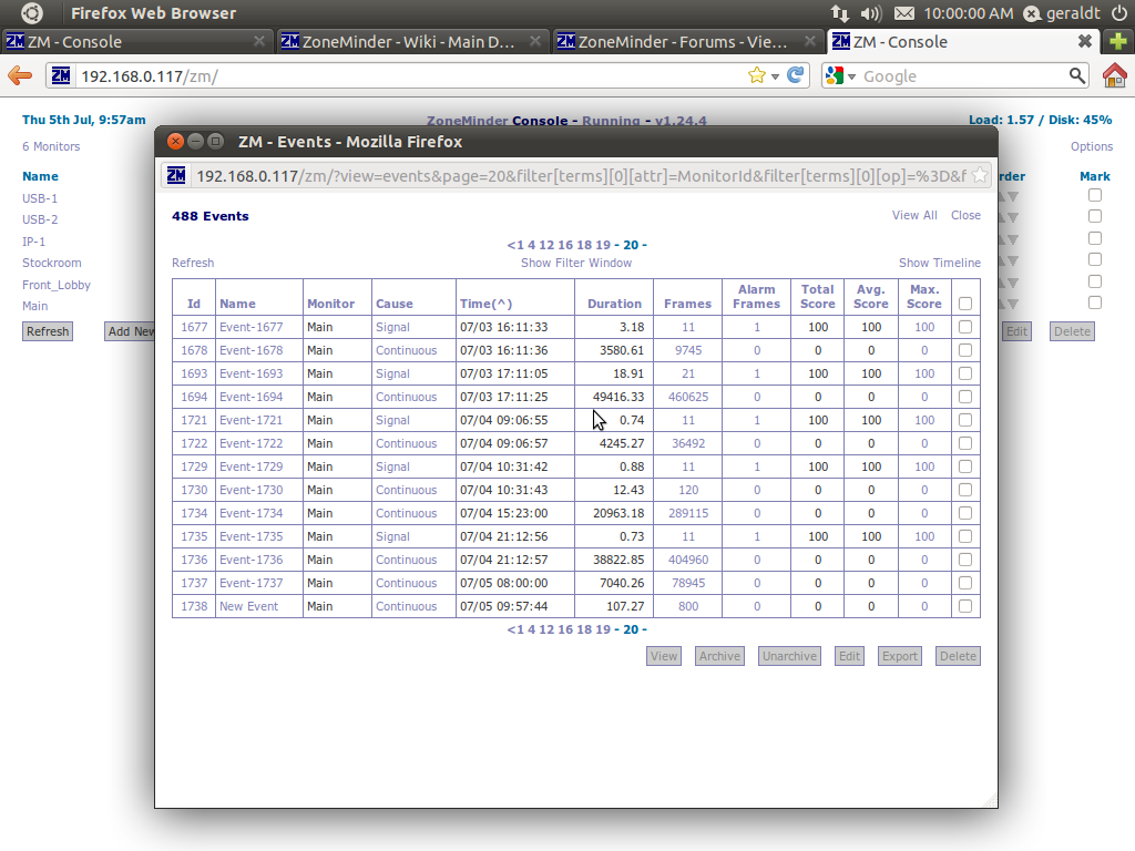

Also, on my IP cameras, how many frames captured before it is stopped with a Signal Event changes; there are times it can only capture 200 to some thousands of frames (as can be seen on the first screenshot), and some events go up to hundreds of thousands of frames (as can be seen on the second screenshot). The signal events that cuts the recording events are either 11 frames or 21 frames, and when I view that, it shows the frame where it stopped and the screen turns to blue.
In this screenshot, the frames are around thousands..
And here, it goes up to 400,000+ frames..

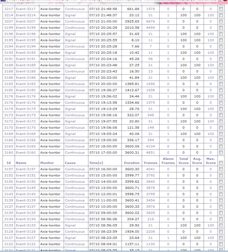

I guess I have the same problem. What could cause these signals i wonder? I have one camera in local network and two in remote location (2x Axis and 1 DLink) - all of them have these Signals at random times. So this should not be a network or specific camera issue..
It does not matter, if I set the recording to Record or Modetect. If there is no motion, these Signals still gets generated..
I have no such problems with my analog cameras (also running in zoneminder with capture cards)
This is todays events from my remote camera. What's weird - it ran without problems for 10 hours and then the Signals started. Other ones sometimes manage to run 3 to 4 hours without Signals.
I don't get it :?
