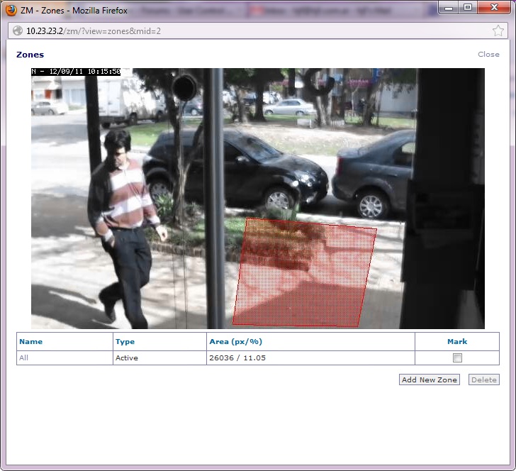

I have set a camera pointing out at the glass door in my shop. I've set the zone as attached.
The problem is that, of course, I get a lot of false positives because of people just passing by (unfortunately, business is not so good that there are more people coming in :P).
What I'd like to do is set up ZM so it only records a person standing in front of my door. Is it possible? For example, if the person has been standing in the motion detect area for, say, 3 seconds, only then consider it as motion and generate an event.

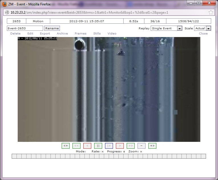

That's excellent, thanks! I've tried it and it seems to work, except i get some false alarms because of weird images. What could be causing this? The camera is an ubiquiti aircam, it's h.264. The server is remote, over a 1km wireless link, could that be dropping packets and causing the corruption?
Sin título.jpg (101.72 KiB) Viewed 4216 times

Try decreasing frame rate from the ubuquiti cam (not from zoneminder settings but camera settings). Do the same errors occur when using ffmpeg?

UPDATE: I've been running the camera for 12 hours now over a wired connection. No issues whatsoever. It seems the image problems were caused by packet loss over the wireless link.
(This is a slow ~6mbit, lossy link, as it's 1KM, with no line of sight, thanks to the 900MHz band. It works even with 3 10-story buildings in the middle).
