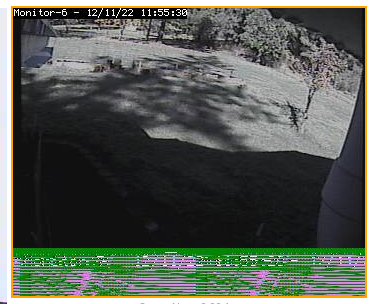

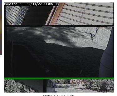

On both monitors, the old camera and the new camera, I get an extra band of "stuff" at the bottom. It looks like part of the image from Camera2 is showing up on Camera1 monitor, and vice versa. I've attached a screen cap from Camera1/Monitor6 and Camera2/Monitor7 so you can see what I'm trying to describe.
The problem is that Camera1 is set to "modetect" and my movement on Camera2 is raising hundreds of alarms on Camera1 (Camera2 is sitting on my desk pointing at me at this time). I believe that the image from Camera2/Monitor7 that bleeds on to Camera1/Monitor6 is triggering the alarm.

- Screen cap of monitor 7
- Monitor7.png (129.21 KiB) Viewed 3718 times
- This is the screen cap of Monitor6
- Monitor6.png (145.52 KiB) Viewed 3718 times
