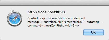

The PopUp Window with the error
Hi there,
I'm having problem with the control of my Foscam FI8910W IP based cameras!
The recipe on the wikis.zoneminder.com has been use to set it up (http://www.zoneminder.com/wiki/index.php/Foscam_FI8918W) There is the info that model FI8910W uses the same command as the FI8918W model.
I'm 110% sure that the came operates correctly, as I'm able to send the command via a browser to the camera, that works as expected!
The error that I'm getting is a popup Window. Attached (Ignore the fact the it shows http://localhost:8090 as I'm connecting via a SSH connection)
And I'm getting this in the log file:
Jan 4 10:42:14 Samba64 zmcontrol[21512]: INF [Starting control server 3/Foscam]
Jan 4 10:42:14 Samba64 zmcontrol[21524]: INF [Control server 3/Foscam starting at 13/01/04 10:42:14]
Jan 4 10:42:24 Samba64 zmcontrol[21512]: FAT [Can't connect: No such file or directory]
Jan 4 10:42:24 Samba64 web_php[2125]: ERR [/usr/local/bin/zmcontrol.pl --autostop --command=moveConDown --id=3=>]
Note the "[Can't connect: No such file or directory]" I think this might be the problem!

chr1s
Joined: Tue Jan 15, 2013 8:41 am
Re: ZoneMinder 1.25.0 with Foscam FI8920W Control problem
Post by chr1s »
you have to edit your pm file according to Version 1.25.
As described for FI8918W (http://www.zoneminder.com/wiki/index.php/Foscam_FI8918W) change your file like this:
#use ZoneMinder::Debug qw(:all);
use ZoneMinder::Logger qw(:all);
Greets,
