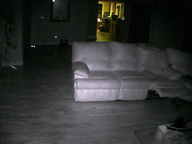

Thanks for the reply and suggestion.
ADD JPEG COMMENTS is indeed turned off (by default it seems)
Then, I made sure that the snapshot that ZM gets is indeed a jpeg:
gandalfthegreat:/tmp# identify snapshot.jpg
JPEG 640x480 640x480+0+0 8-bit DirectClass 29.3KB 0.000u 0:00.000
I'm attaching an actual snapshot in case that helps.
My source is configured as http with
/snapshot.cgi?user=user&pwd=pwd&resolution=32&rate=3
I get the same error with foscam 8910 or wansview.
Mmmh, I also just found out that all the log entries end up in mysql, are creating a huge table, and seem to be making everything either very slow, and maybe even crashing mysql in the end.
Logging to mysql as the log table fills up makes ZM very slow and unresponsive until I manually truncate the table.
Looking in the config, I just found (in case someone finds this post) that one must set LOG_LEVEL_DATABASE to none to turn off mysql logging.
google zoneminder-foscam-fi8918w-war-corrupt-jpeg-data-extraneous-bytes-before-marker-0xd9 (I can't post URLs, great...) says that one can recompile libjpeg to remove the warning, but I'd rather not do that because my next system upgrade will re-install a libjpeg that will spam my logs again.
Turning off mysql logging since it's unable to filter logs, and filtering the error in rsyslog seems to have taken care of the problem for me.
If you are using another syslog, install rsyslog and then add this line at the top of the config:
:msg, contains, "Corrupt JPEG data" ~
foscam sucks for making bad jpegs
