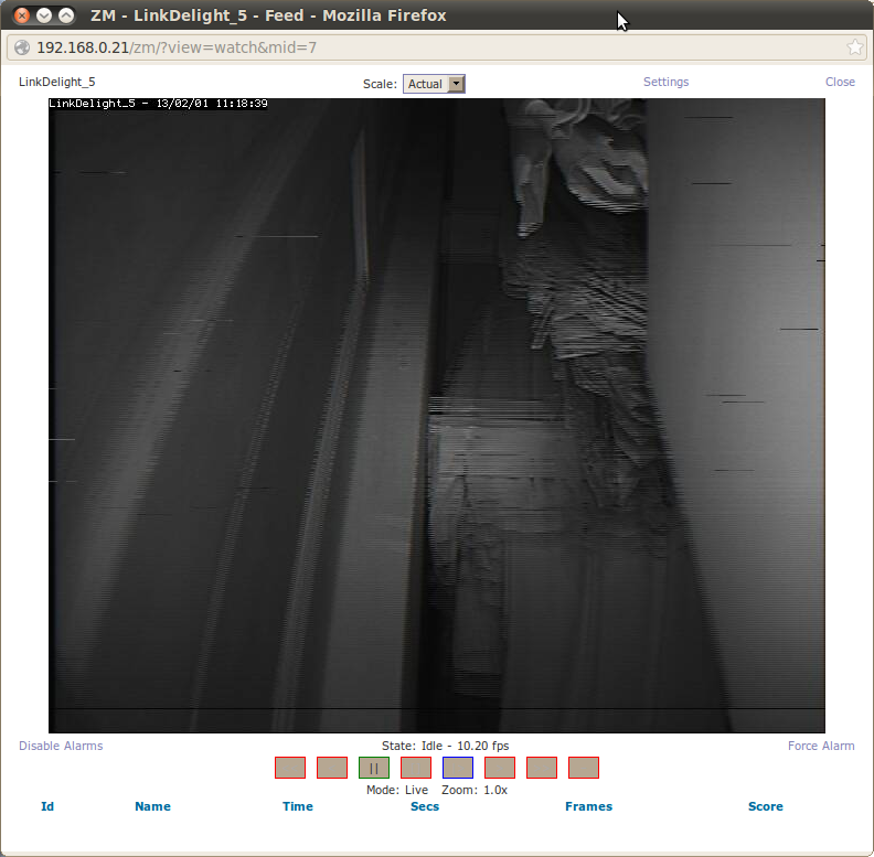

I am setting up ZM 1.25 from scratch on Lubuntu 12.10. For the last couple of years I used ZM 1.24 & Ubuntu 10.04.
I posted some info in http://www.zoneminder.com/forums/viewto ... 14&t=20507 about my config.
On my new install I am using a LinkDelight 8 channel card with two TW6816 chips. I have been testing with 2 CCTV cameras on Video0 and Video1 for a few weeks. It has been running perfectly with 2 cameras both at 25fps.
Yesterday I connected 2 more cameras on Video4 and Video5, they are attached to the second TW6816 chip but now all images from all cameras are corrupted. Frames appear overlayed and shifted vertically and also have horizontal stripes. It is not normal interlacing caused by PAL I know that well and it doesnt bother me if a single frame has a slight combing effect.
The situation improves if I set the max frame rate to 10fps on each camera but I still get a lot of bad frames. I am now getting a total of 40fps whereas before it was 50fps.
System load is 0.20 and Disk used 2%.
I there anything I can do about this? I'll post a sample image.

Sample
- image
- ZM_Noisy_Interlaced.png (217.17 KiB) Viewed 14466 times

Under options
How many images are captured per returned frame, for shared local cameras
Change that to 4 I think. Since you have a 2 chip card thats 4 cameras per chip.
Re: Noisy, interlaced frames after adding two more PAL camer
Yep, change options::config::CAPTURES_PER_FRAME to value of 2 and/or untick V4L_MULTI_BUFFER

Thanks for the suggestions. They seemed to help but do not fix the problem completely. The only thing that really works is to reduce the Max fps on all cameras down to about 5. Vetry disappointing for a card that supports 200 fps.

If your still getting scan lines you might want to try changing your camera resolution. Something like 320x240 or whatever the pal equivalent is. I remember when I had analog cameras I tried upping the resolution from 320x240 to 640x480 and had noticeable scan lines kind of like whats in your screen shot. If you go to a higher resolution than your camera can support you will see lines like that.

I want the highest resolution possible from the system. The analog cameras are 700 TVL and I am using 704*576 and I used that with two cameras quite happily for a couple of years. Interlaced alternate line scans should have no effect on static images as above. You will notice that some combing is in effect giving a zig zag appearance to vertical lines, that should not happen here. And if you look closer you see the frames slip out of sync. At the top the alternate scans are in sync but towards the bottom it is way out. So I have some like

I am posting a follow-up incase anyone else has this problem and i want to document the whole story.
I installed Ubuntu 10.04.4 LTS and Zoneminder 1.24. I got exactly the same problems as described above. The only way to stablise the image is to reduce the max fps on all cameras to about 5. Looking at a TOP display shows there is plenty of CPU power spare, zmc 3% per cam at 5fps. I turned on a small area on all cams for Mocord and zma uses about 20% CPU each cam. Also "cat /proc/cpuinfo" still shows the CPU sometimes at 2400Mhz and sometimes throttled down at 800Mhz even with Mocord. There are no memory related errors in the logs but I have just ordered some more RAM so I'll have 4Gb instead of 1GB (onboard graphics grabbing 128MB) as I would like more buffers to hold pre/post images for events.

Got your PM. Deinterlacing is implemented in this version http://www.zoneminder.com/forums/viewto ... =9&t=17652.

i got the web interface for Motion working. No laggy interface like with ZM. Motion doesnt have all the options of ZM and its all configured with one or more text files. but there again it is working after a hour or so where-as ZM is still unuseable after weeks. I need to play with motion detection and if that works OK it looks like I'll be ditching ZM. It's a pity because ZM is so promising and at least it still appears to still be under developement.

My config option for Motion are
v4l2_palette 8
width 720
height 576
framerate 10
pre_capture 5
post_capture 5
snapshot_interval 60
ffmpeg_cap_new off
ffmpeg_timelapse 5
ffmpeg_deinterlace on
Each camera has its own config file containing two lines like this
videodevice /dev/video1
webcam_port 8091
There are no complex set up or options as in ZM. The deinterlace option is required and does smooth out PAL interlacing when movement occurs.
