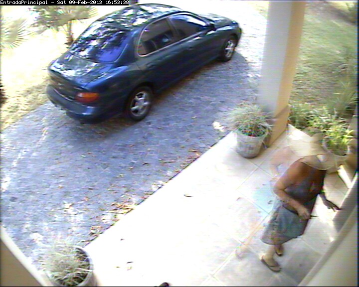

Problem 1: horizontal lines in frames with movement. See image1.jpg. Do I need to activate some kind of comb filter?

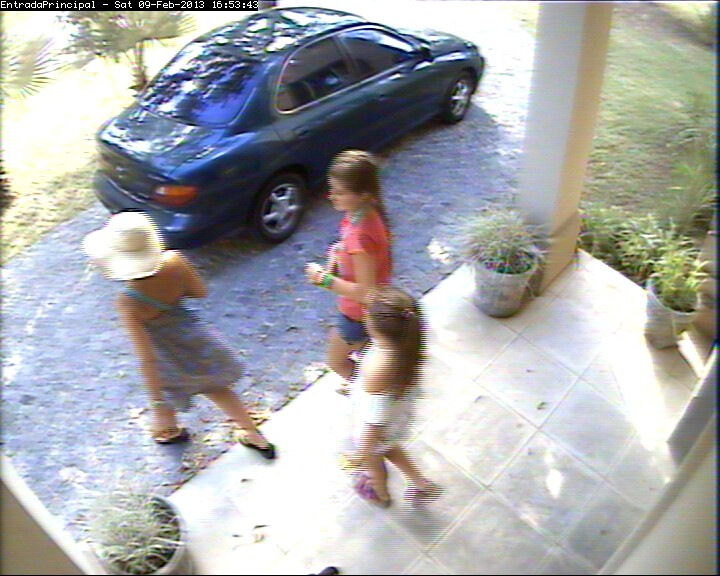

Problem 2: frames with ghosts
In the same frame I get two images of a person, the current one and an old one, from 5 or 6 frames ago. See image2.jpg. Sounds like a software bug since I don't think the camera has any frame buffers.
Problem 3: image seems to blend two frames in one. Check out image1 and look at the girl's foot in the bottom right. It's in two places in the same image. Is this done on purpose to make the transition between frames smoother?

Re: Kodicom 4400R+analog cams = horrible image & buggy seque
I was about to give up on zm until I tried this: http://www.zoneminder.com/forums/viewto ... =9&t=20587
Wow! What a change! Now I get perfect deinterlaced image.
