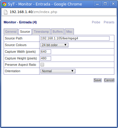

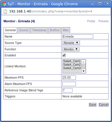

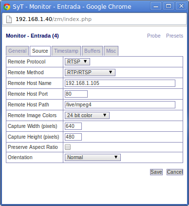

Bellow is the cam configuration in ZoneMinder:

Hi, I get the same error with the following configuration
I also tried using rtsp://192.168.1.105/live/mpeg4 as source path

View your camera in a browser and look at the source or properties and verify the resolution is 640*480. If it is set the camera resolution in it's firmware to 320*240 and adjust in ZM also to see what happens.
bb99
Posts: 943
Re: "No main content type" while trying to open rtsp camera
Post by bb99 »
Also verify the cameras path as you read through the source info.

Well, that's the thing, I can view the stream from VideoLAN but not from ZoneMinder,
VideoLAN says the frame is 640x480, and it opens it with that URL
Is there any way to check if ZoneMinder actually gets the stream but is not able to show it in the browser?
