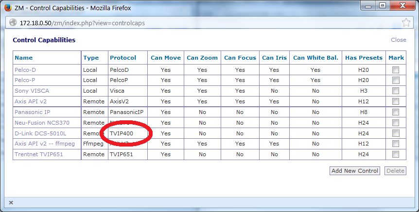

When you're in the control capabilities section, the "protocol" must match the package name (not the filename)! So unless you edited the file, "TVIP400" must be the protocol name!
Here is my definition for the 5010-L, for example.
HTH!

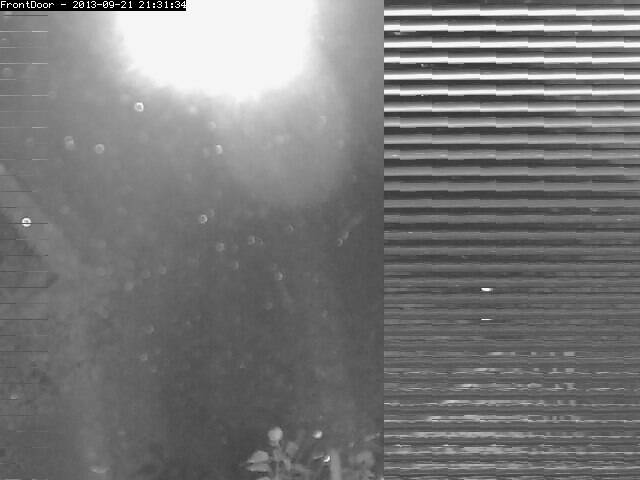

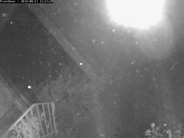

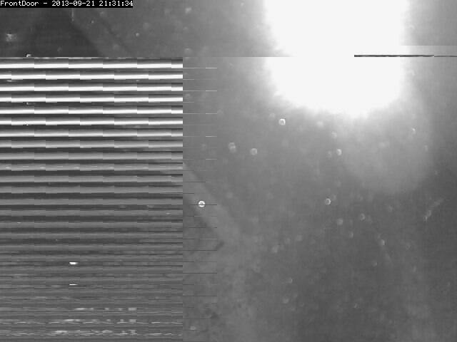

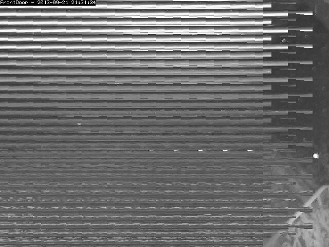

One thing... do(es) your 5020L(s) every once in a while send corrupt frames? Both of my 5010L's will occasionally send a corrupt frame or two. Obviously this then triggers motion detection for a false event. Was wondering if it happens to anyone else.
Doing fine...
Doing fine...
....whoa!
....whoa!
Earthquake!!
Earthquake!!
TheKorn
Posts: 142
Joined: Fri Aug 02, 2013 12:39 pm
Re: DLink PTZ cam not recognizing PTZ clicks
Post by TheKorn »
And then just as quickly as it starts sending corrupt frames, it quits!
Gonna hurl!
Gonna hurl!
...back to normal in five frames or less!
