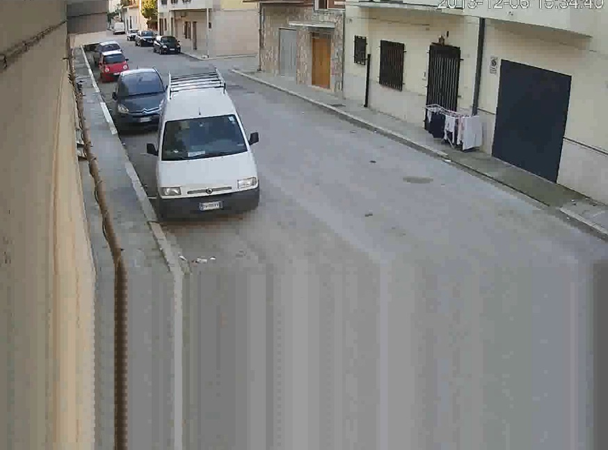

Hi I've also a Dahua IP camera via RTSP on a ubuntu machine. I have some decoding errors both in zoneminder 1.24.4 and 1.26.4.1
See the attached screenshot.
How can I solve?
Biggus
Posts: 96
Joined: Mon Nov 18, 2013 9:15 am
Re: 1.26.4 Upgrade Failure
Post by Biggus »
I get lots of these smears on my cameras too! Wish I knew how to solve it.
c128
Posts: 88
Joined: Sat Sep 14, 2013 3:36 pm
Post by c128 »
Biggus wrote:I get lots of these smears on my cameras too! Wish I knew how to solve it.
YMMV, but I have these issues with all of my h.264 cameras using camera default settings and ffmpeg with ZM 1.26.3 - Foscam, Merrit Lilin and Hikvision. All of them work acceptably (depending on the camera) by dropping frame rate, bit rate and/or enforcing TCP with a "?tcp" query string parameter on the RTSP URL. Forcing TCP doesn't work with the Foscam camera, but then that just has buggy RTSP anyway - dropping frame and bit rate removes the smearing with that.
I'd try forcing TCP first on the RTSP URL as a first port of call, then try reducing bit/frame rate on the cameras themselves.
