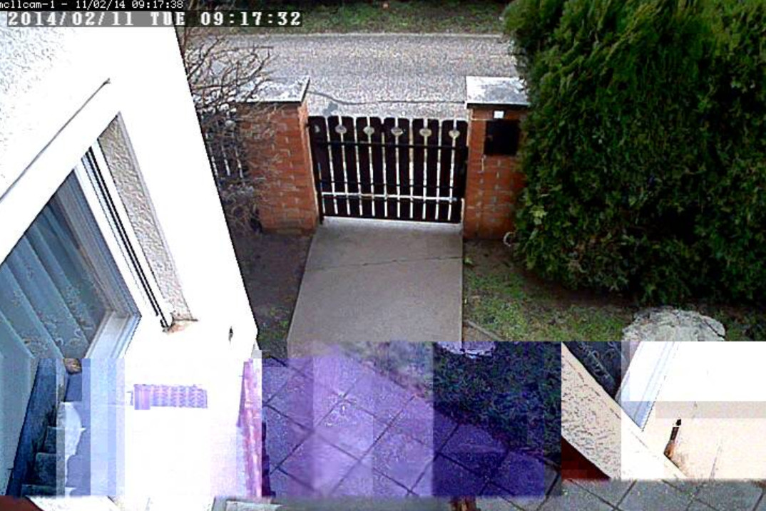

I'm using v1.26.5 on Ubuntu Server 12.04LTS. It's working fine, but every morning i get sometimes crashed pictures like this:
The lower part of Picture is like inverted or so. This happens only in the morning hours for several times, after the camera is switching from night to day mode. I'm using the cam AVTECH AVN257. This picture Problem is generated by the ZM Software, because the stream of the cam doesn't have any problems like this.
Another problem i encountered is that sometimes (in a week once, or twice) i get an alarm when nothing moves on the screen, and this event records durations is over 600 or even 1200 secs.
Did someone get this kind of errors?
Regards
Laszlo

I have seen it before, not with zoneminder however, but it is caused by jpeg corruption. If this occurs only when the IR cutter is moving, it may be a limitation of the camera to handle the "flashing" from the transition of the cutter. Does this clear up as the imagery "calms down"? Do you have multiple cameras of the same type and are they also experiencing the issue? Is this a network camera? I would suspect that you may also see delay (more importantly a large amount of jitter) as the cutter is moved into position.

It shouldn't corrupt the JPEG data though, which I agree is what it looks like there. Unless it's some weird reflection off the moving optics. But I don't think it is.

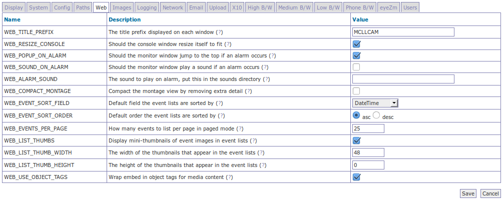

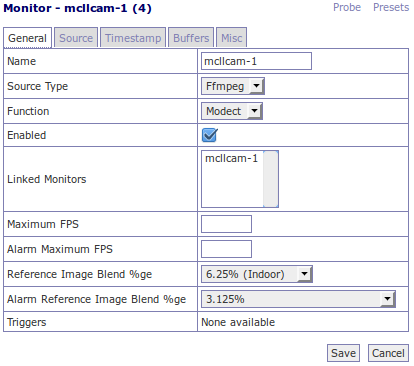

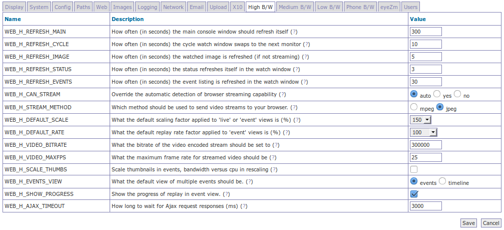

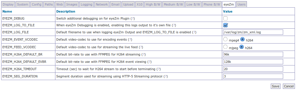

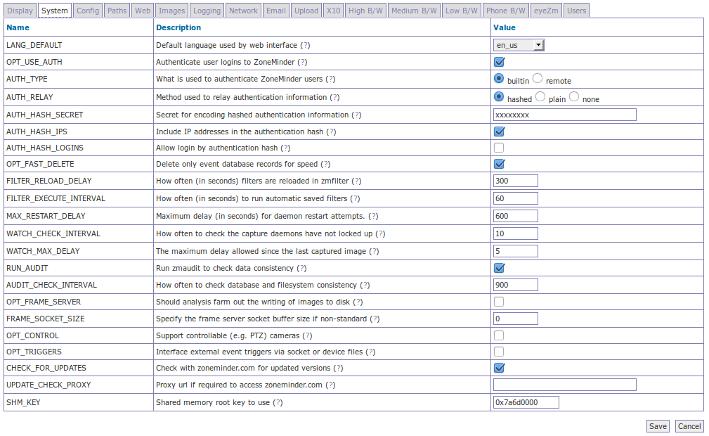

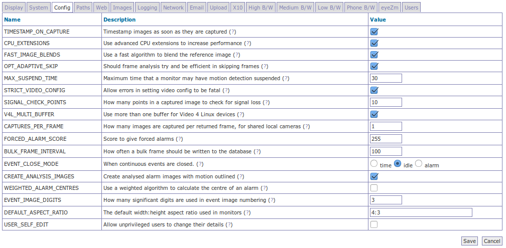

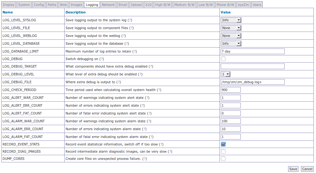

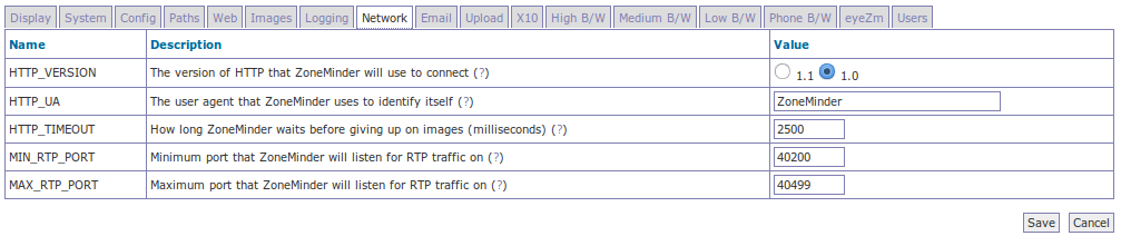

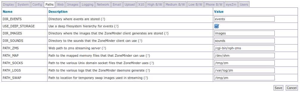

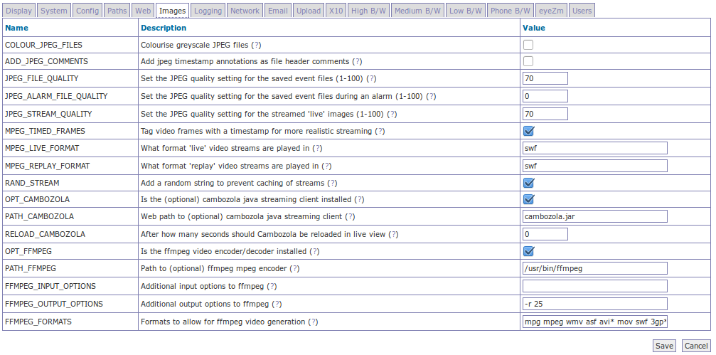

Here are my current settings, maybe someone here can find some problems in my settings. :) (or if you find points where to be improved, than let me know pls.)
Re: Interesting picture
Posted: Mon Feb 17, 2014 6:19 pm
by mcll
Posted: Mon Feb 17, 2014 6:20 pm
by mcll
Sorry for the pictures.. ;)
Email, Upload and X10 options are disabled.

I've seen your YouTube videos, that is data corruption in the data stream. Never mind about the IR cut filter bit!

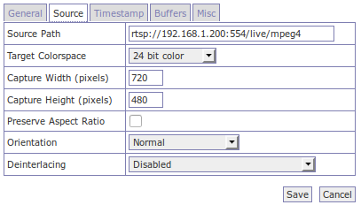

When you were suggested to leave the Maximum FPS blank -- that needs to be in ZoneMinder, not the camera. At the camera, set the framerate you want. At ZoneMinder, set it BLANK, and it will deal with whatever the camera throws at it. Do not set a FPS at both ends, even if you think it's the same, it causes trouble!
All those tabs you posted -- it's not on them -- there's more config elsewhere ... :)
Click on your "Source" link for the camera, then go to "General" tab, see "Maximum FPS" ?? Empty that field.
Posted: Mon Feb 17, 2014 7:55 pm
by mcll
mikb wrote:I've seen your YouTube videos, that is data corruption in the data stream....
...All those tabs you posted -- it's not on them -- there's more config elsewhere ... :)
Yes i think it's a datat corruption. But why, what's causing it? :)
OK i have now that settings, but as i see it's already empty.

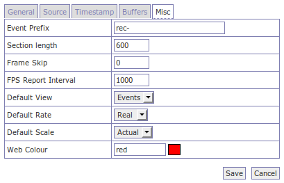

Here other camera settings:
