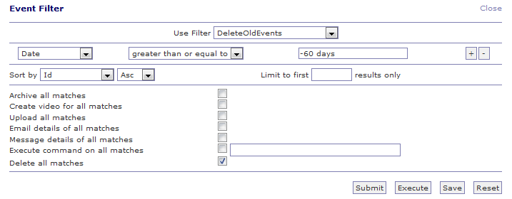

Hello I would like to create a filter for the events which I delete all events at 60 days and could do that from already thank you very much.

There is an example in the attached image, addapt it to your needs, if you put a number in the "Limit to first XX results", will apply the filter only to the number of matches to the filter. Remember to check the "Run filter in background" when saving the filter, otherwise it would not run.
Hope it helps.
