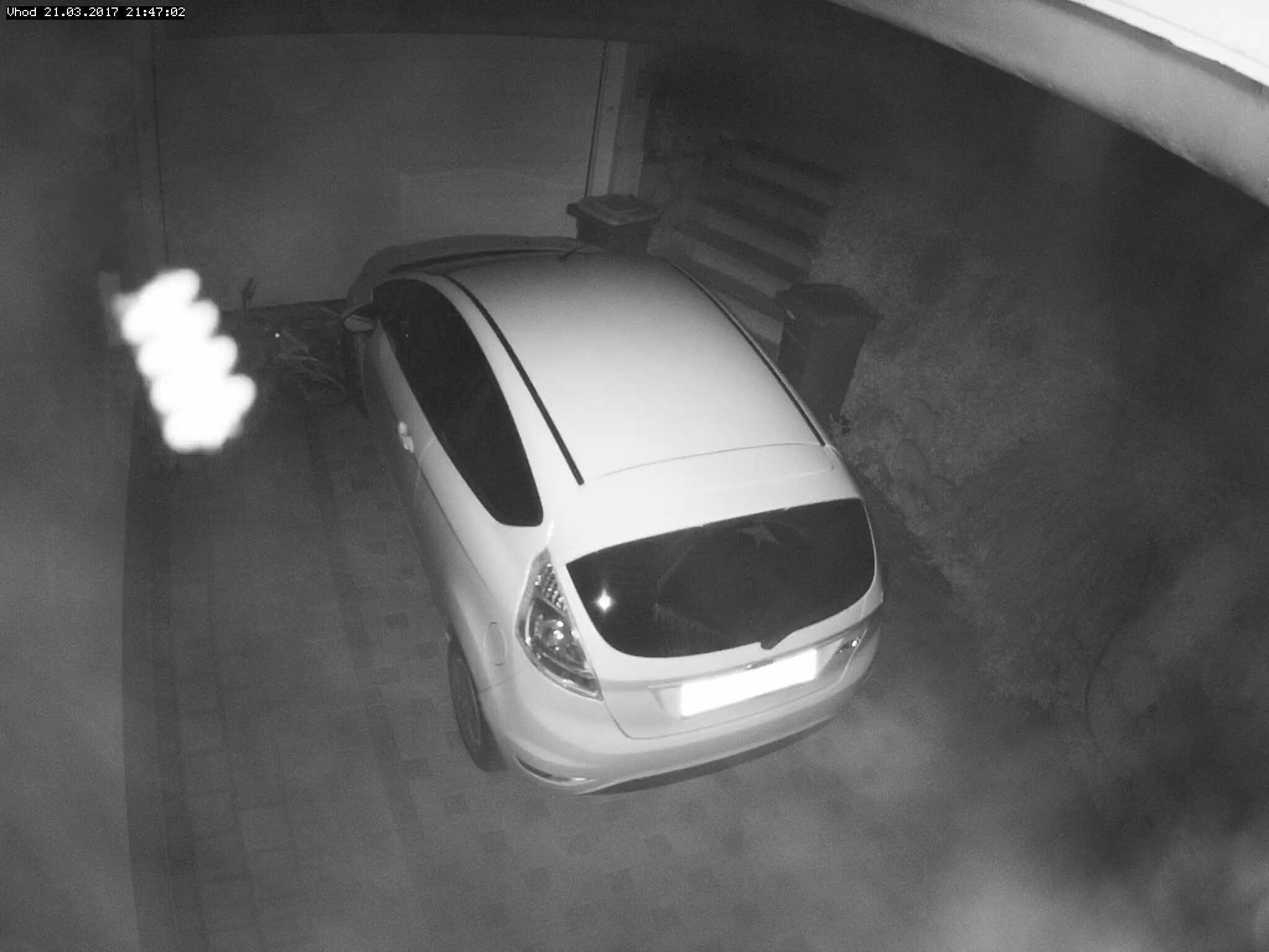

HI!
Have the exact same issue. See the attached photo. Looks like fast worms travel over the view area very near the camera. It lasts only 1 to 2 frames.
Over the night there were more than 70 detected movements. That is very annoying.
The camera is Dahua DH-IPC-HFW2320R-ZSVFS (3MP, motorized lenses, 4 strong IR LEDs). The motion detection is on a second VGA resolution stream.
ZM-1.30
Another camera from Tiandy (4MP) is also connected, but there are no "worms" over night (but IR lightning is awfull, 24 LEDs, each creates bubble on the frames).
Have anybody any solution to the "worms" problem - eliminating movement detection - camera settings or Zoneminder zone settings?
Looks like there is a large number of users having the same problems waiting for a solution?
Someone mentioned UFO - it is not the right place for that, and make full of a real problem is not a polite way of writing.
Regrads to all
ZM-1.30
Regrads to all
- Worms.jpg (16.92 KiB) Viewed 77191 times

You could try playing the zone settings to increase the alarm thresholds, so 1or 2 frames don't trigger the alarm, people don't move that fast. Image posted it is hard to tell, but normally for me white fast streaks are bugs who love IR. Mounting IR elsewhere and disabling cameras IR can help.

Hi Steve!
Thank you for a suggestons. It's impossible to eliminate alarms triggered by those arifacts. They dance allover for a few hours and at one time they completely vanish. Some nights are very disturbing for cameras, and some are entirely quiet (100% absent of those worms). Those were no living species or dust. The image was captured at -15 deg. Celsius on a very cold winter night.
Some mentioned conspiracy theory: Artifical nano particles from flying objects over our heads poisoning us.
I do not have any logical (physical) explanation for this.
I can confirm only that this phenomenon is independent of weather, humidity, air temperature, and time. It's only visible at night, sometimes it lasts hours, sometimes only a short time (hour), sometimes spend a night without any.
Search online returns a lot of that all over the world.
So the explanations are very welcome.
Regards.

If you are saying independent of weather then I am stumped. If it was just occurring in -15C I would be wondering if it was some form of condensation or heat vs cold effect. We only see the opposite weather here +40C.
If you are interested in playing I would try a cheap IR light instead of the built in leds, see if it is some reflection type issue. Or use an exterior light to force camera into day mode and see if same thing appears.
Real pain in the butt so hopefully you can find the cause.

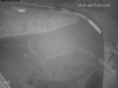

Re: IR camera and fog
Here is spring right now.
The cameras catches some moths during the night mode with IR lights.
I append the original size photo from the second camera. It catched a "flying spring". Looks artifical to me.
The camera is set at 10 photos /second, and there were 3 with that spring. All are the same with no change in shape, direction, rotation or else. The direction of movement is in line with the long side of this thing.
I have successfuly reduced alarms created by those things to acceptable minimum - 0 to < 5 over night.
There were much more this UFOs over winter. Strange as there is no rain for over 6 weeks and nature is dried, dust was expected.
I was reading about night view, IR LEDs in camera and suggestions like here.
Do not bother me much, just curiosity. Want to have simple system, remote IR lights complicate this, as they need power suply. All my cameras are POE. So just UTP cables and no other wires.
- spring_g.jpg (309.33 KiB) Viewed 76751 times
