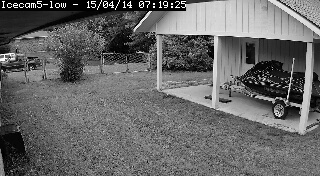

I have four Grandstream GXV-3672-FHD cameras, two of them are the base model, two have a 3.6mm lens for a wide angle view. One of the wide angle cams is throwing a lot of events due to smearing. The other 3 don't do this at all, or at most very very infrequently.
For instance, I cleared out all the events about 30 minutes ago, 3 cameras have detected no events in that time, the one odd-ball is showing 8 events. When I look at the alarm frames they're all due to smearing in the image.
I've checked settings, all the cameras are configured the same, all the monitor definitions in zoneminder are the same. Can't figure out why this one camera is doing this.
Any thoughts on what could cause this? Could it just be bad hardware?
Added: The attached images are from the low def stream that I set up as modect, the hidef stream is set up nodect and linked to the lowdef monitor. When I look at the frames from the same event on the hidef side I don't see smearing in those frames. I've considered just dumping the lowdef streams and do everything in hidef but I'd be concerned about the extra workload on the system having to analyze 1920x1088 frames instead of the 320x176 frames.

- Non smeared image.
- no-smear-example.jpg (35.93 KiB) Viewed 7892 times
- First smeared image from one event.
- smear-example.jpg (30.33 KiB) Viewed 7892 times

All the cameras are set (within the camera setup) to 10fps, I've matched that on the zoneminder side. (When I shouldn't have)
Or at least I thought I had.
I found the oddball camera set to 10fps along with another camera. I must have gotten used to setting 10fps whenever I saw the option. I've reset it to be blank on the zm side, will let it run for awhile and see what happens.

Yep, when I look at a montage of low def streams they are all showing up as running at 10.27 or 10.28fps. It's looking a whole lot like that was the borked up bit. Fifteen minutes later and no false events, no smearing that I've been able to see.linuxsense wrote:That might help out quite a bit. I had a cam at 10 fps and with ZM also set to 10 fps it would hang the stream and provide funky images. Leaving the ZM fps setting blank sorted it out. I think that although set to 10 fps on the camera it was actually running 10.4 fps (give or take) so ZM was trying to limit it.
Amazing how one little slip of the keyboard will drive you frakkin nuts. On the up side, I now have 5 of my six cameras set up in ZM, and showing a load average of about 1.5 on a Core i7 3.4GHz, 8 core, 16GB system. I'm liking this IP camera set up more and more each day.
