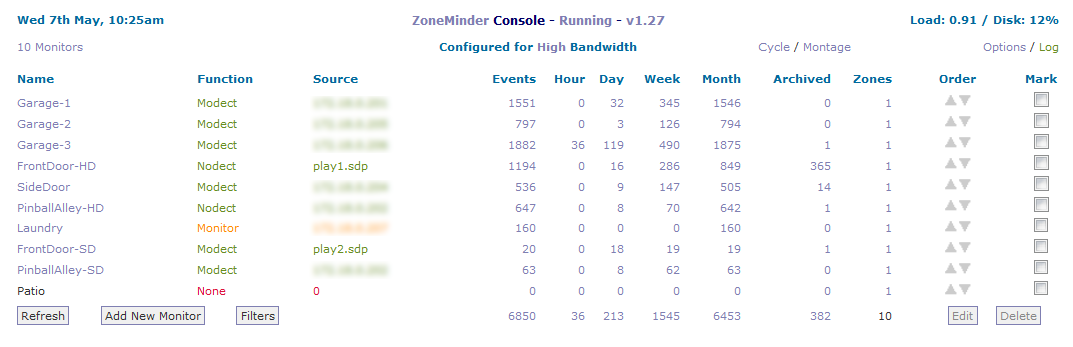

rodeored wrote:What's the difference between a monitor that's working and a monitor that's not working? I mean besides the fact that the image is not there.
That is the difference! You're asking zm to display a picture (video) that doesn't exist as it was never collected in the first place. "What's on page 12?" isn't a valid question if the book hasn't been written.
The way to tell is to look at the color of the monitor line. Red indicates an error condition. For example, my patio camera is on the fritz so I have it turned off in zoneminder, and that line is red.
If I had simply unplugged it without turning it off in zoneminder, it'd still be red and I could attempt to view a live image. In that case I'd get similar errors as you.
In short, don't worry about those messages until/unless you get the camera working in zoneminder first. You're chasing a symptom, not a cause.
