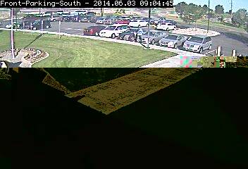

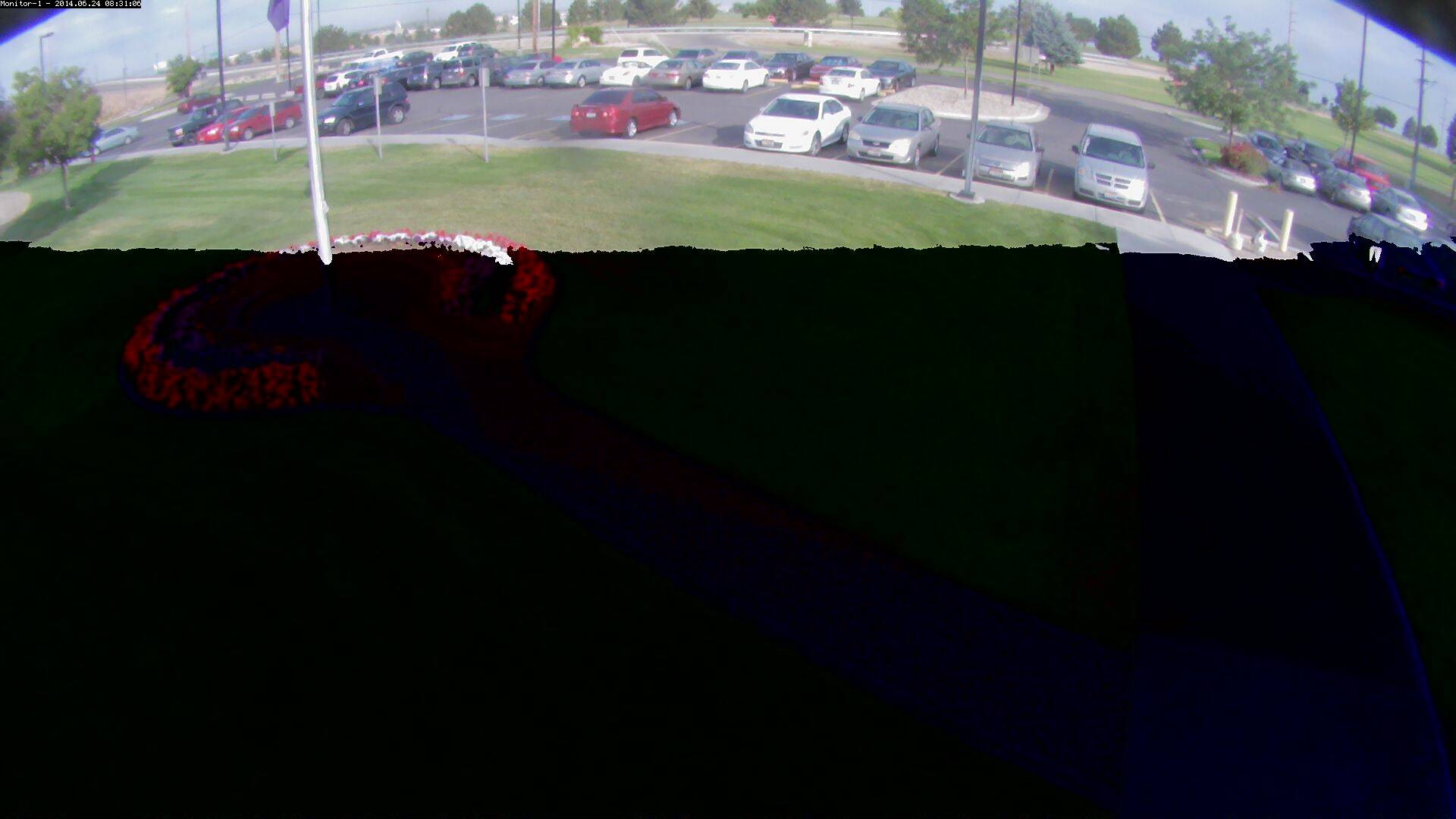

I have a new build i'm testing, with new cameras as well. I am running ZM 1.27 on Ubuntu 12.04.3 LTS. The server has two quad-core Xeon E5606 processors and 16 GB DDR3 ECC memory, 18 TB RAID-5 storage for events. Load likes to hang out around 2 to 3. Highest i've seen is 3.43. It isn't dropping frames or events or anything like that. Log is green.
On this test build I'm recording 8 Vivotek IP8362 cams at 1080p 5 fps, and 10 Axis M3533 cams at 800x600 5 fps. All is well except one of my Vivotek's is starting to get corrupt JPEG images recorded. These look very similar to the corrupt JPEGs I have been getting from my old Toshiba IK-WB70A cameras (still in use on other DVR servers). I suspect the issue is the camera and not ZM, but I wanted to see if anyone else is experiencing similar issues. I saw a thread from about five months ago that shows a similar JPEG corruption issue: http://www.zoneminder.com/forums/viewto ... rupt+video Maybe they are related... I don't know but i'm trying to find the cause of this.
I also have 34 other IP cameras in use on my other (five) DVR servers (older hardware, ZM 1.23.3 on Ubuntu 8.04 LTS for the last five years) and the issue exists on those as well but only for my Toshiba IK-WB70A cameras. No other cameras do this... I have 20 Toshiba IK-WD01A's that don't have this issue at all, along with 14 Axis brand cameras that don't have it either. It is only the WB70A's and the new Vivotek's we just got that seem to be having this issue with corrupt JPEGs.
Attached are stills from the cameras with corrupt picture. The one with "332" is from the Vivotek, and the "1153" is from a Toshiba IK-WB70A.

- 1153-capture.jpg (17.22 KiB) Viewed 7472 times
- 332-capture.jpg (111.53 KiB) Viewed 7472 times
