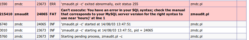

I am encountering an error in the execution of the zmaudit script. The screenshot below describes the error sequence in the system log.
I am running zoneminder on a VBox virtual machine, ubuntu 14.04, zm version 1.26.5 via the iconnor ppa.

For those who do not get to see the screenshot above, the following is the main line involved:
==begin==
Comment: zmaudit
PID: 24065
Level: FAT
Message: Can't execute: You have an error in your SQL syntax; check the manual that corresponds to your MySQL server version for the right syntax to use near 'hours)' at line 1
File: zmaudit.pl
==end==

Re: zmaudit SQL error
I had the same error too. It was a configuration problem of zoneminder. zmaudit.pl is deleting log entrys out of the zoneminder internal LOG table. I set the value of the zoneminder option Logging -> LOG_DATABASE_LIMIT from "2 hours" to "2 hour".
This is also specified like this in the help text.
If this does not solve the problem, it is possible that you can find it out if you execute sudo zmaudit.pl at the commandline and see at which line of zmaudit.pl the mysql errror happens.
