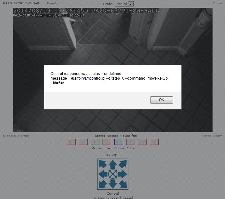

When using any of the controls on the monitor, I receive the following error:
/var/log/syslog contains the following entry:
(First two lines occur at button press, third line occurs after error displays)
Aug 19 19:05:24 CharZoneMinder01 zmcontrol[20181]: INF [Starting control server 6/TVIP672PI]
Aug 19 19:05:24 CharZoneMinder01 zmcontrol[20184]: INF [Control server 6/TVIP672PI starting at 14/08/19 19:05:24]
Aug 19 19:05:34 CharZoneMinder01 zmcontrol[20181]: FAT [Can't connect: No such file or directory]
I changed the control script to use in the control tab of the monitor to one included with ZM when I installed it and still receive the same error this time referencing the other script I chose.

Is there any way I can find out where ZM is looking for these scripts?
Unable to use any control script - "FAT [Can't Connect: ..."
