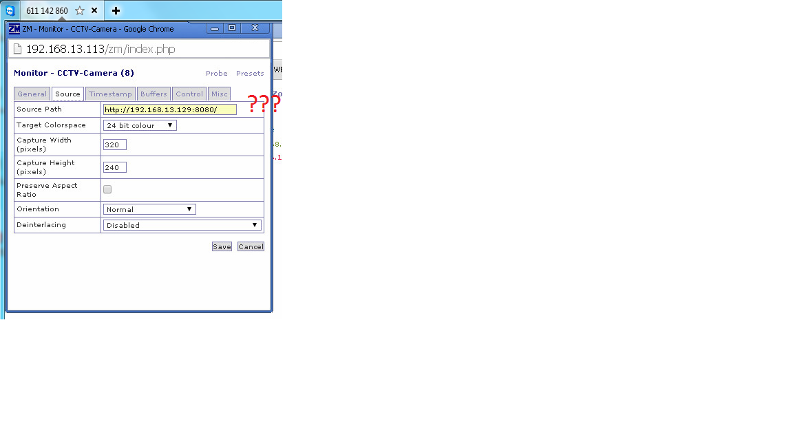

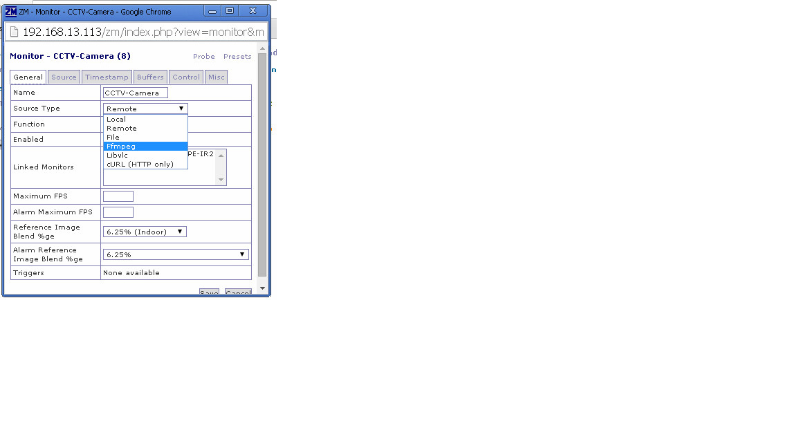

Many thanks for clarification, but still not completely enlightened. I have attached here 2 snapshoots. I've selected in General tab -> ffmpeg, but I do not know what to configure in source tab -> source path field. Filling with http://192.168.13.129:8080/ I cannot get anything from camera. If camera is configured as REMOTE in General tab, and filled the same URL, I was able to get red console, which mean unrecgonized format to ZM.
What did you configured on your side, for your cameras, in source path filed when ffmpeg is selected.

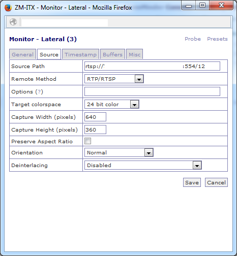

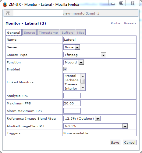

Try to encode the stream as RTSP (https://www.videolan.org/doc/streaming- ... /ch04.html), then fill the monitor settings as shown in the images:
Then you must set the source path according to your settings: rtsp://user:pwd@your.ip.address.camera:port
Good luck,
Post results!
PacoLM
Good luck,
Post results!
PacoLM
