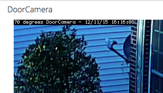

Not quite sure how you are accessing it - you need to provide more details of how you are connecting.
Do this simple test:
telnet <server IP where ZM is running> 6802
Now once you are connected, simply type in
1|show||||70 degrees
And if you have put in a %Q in your timestamp for the monitor Id, you will see it there like this:
Screen Shot 2015-11-12 at 4.16.21 PM.png (110.96 KiB) Viewed 4507 times
Note: There are no quotation marks around the command and I assume monitor 1 (id=1, not name) exists
