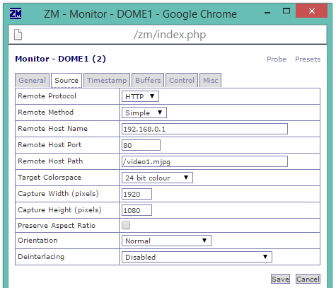

here's a look at current settings... ( and if I choose greyscale, I get a black screen instead of blue... )

Well, well, well...
turns out that the ZM web-interface wasn't accepting my auth, due to PUNCTUATION in the camera admin password. (oops!)
And apparently, the auth IS needed - but the web interface is rejecting punctuation in the remote host name field
Went into camera controller and changed the camera's admin password to one with only alpha-numerics, and then used "user:passwd@IPaddress" as the remote host name, and now I'm getting the video feed in my Monitor :D
