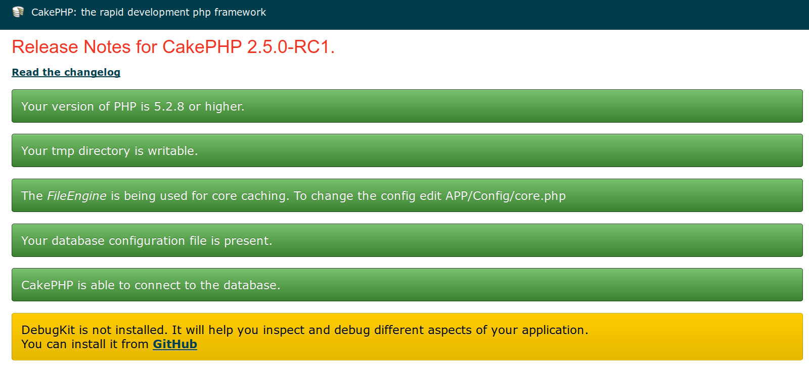

if can be useful, my system have CakePHP 2.5.0-RC1 and php 7.0. Also i have attached my http://zoneminderip/api page.

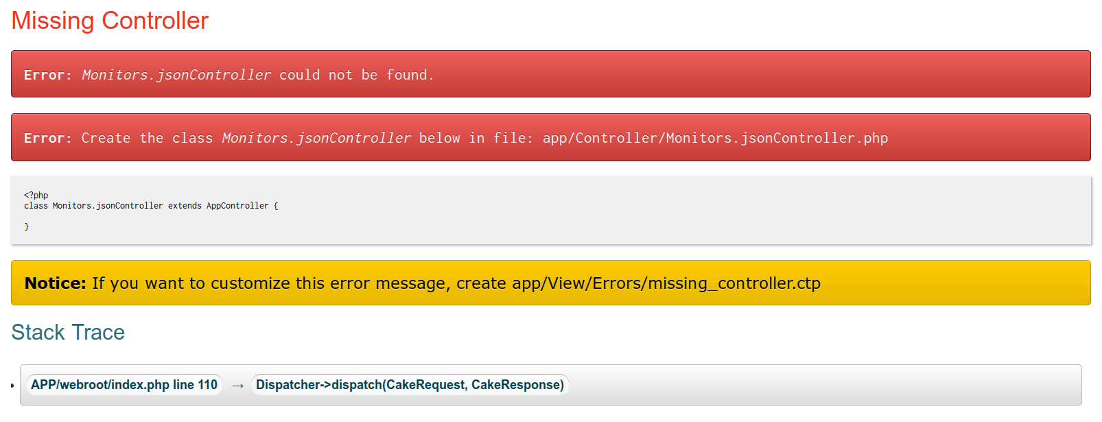

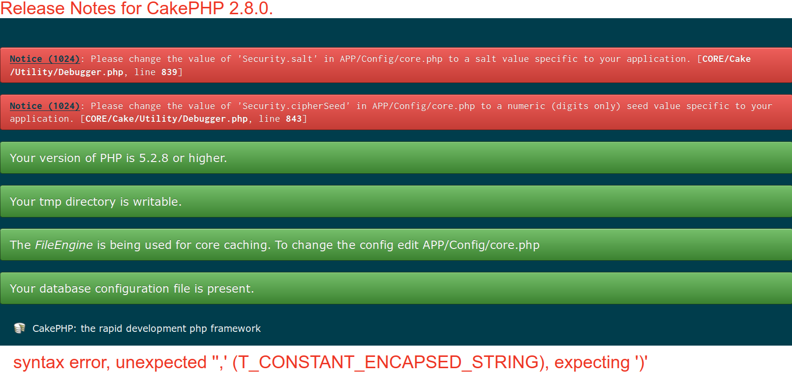

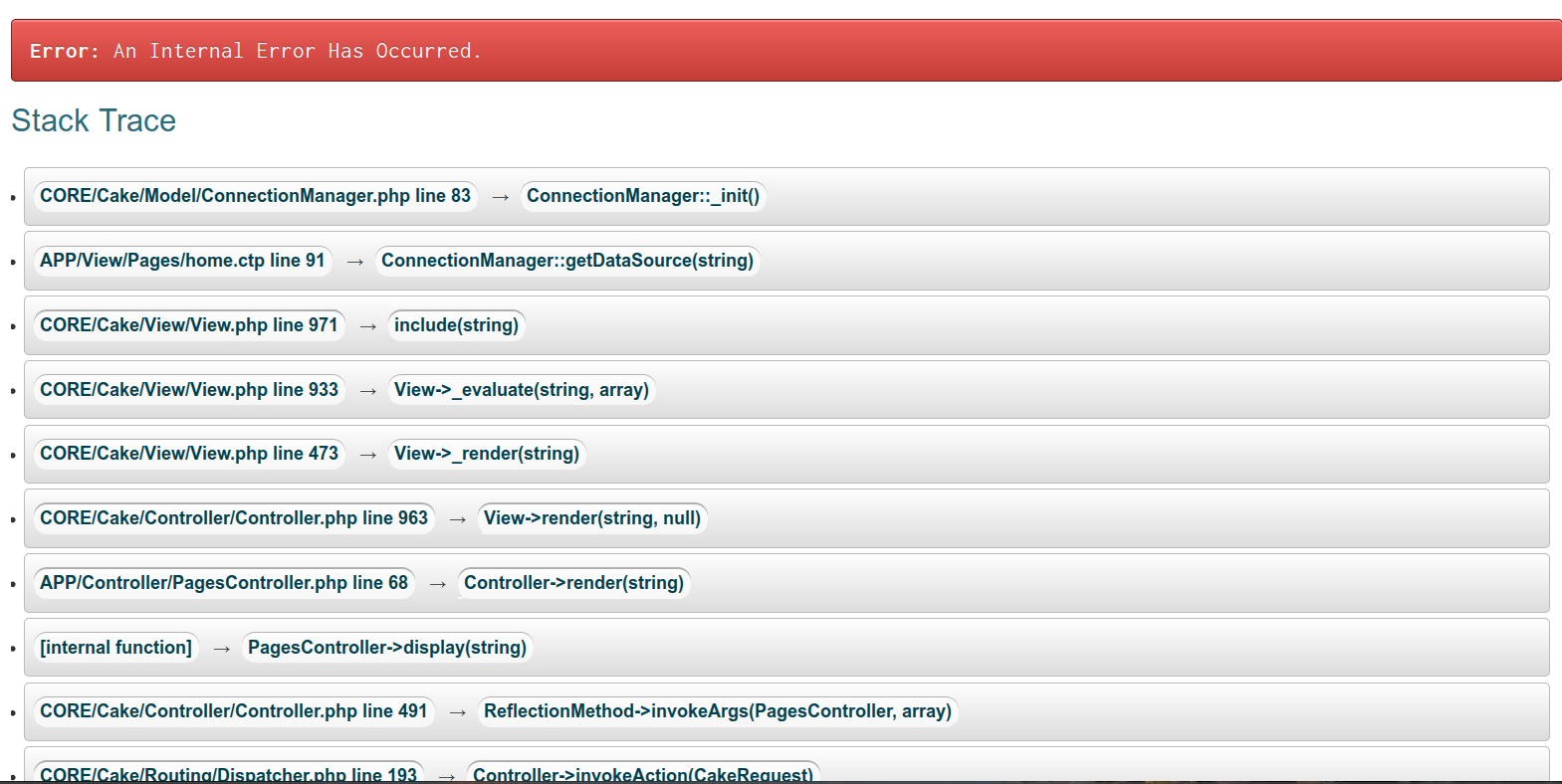

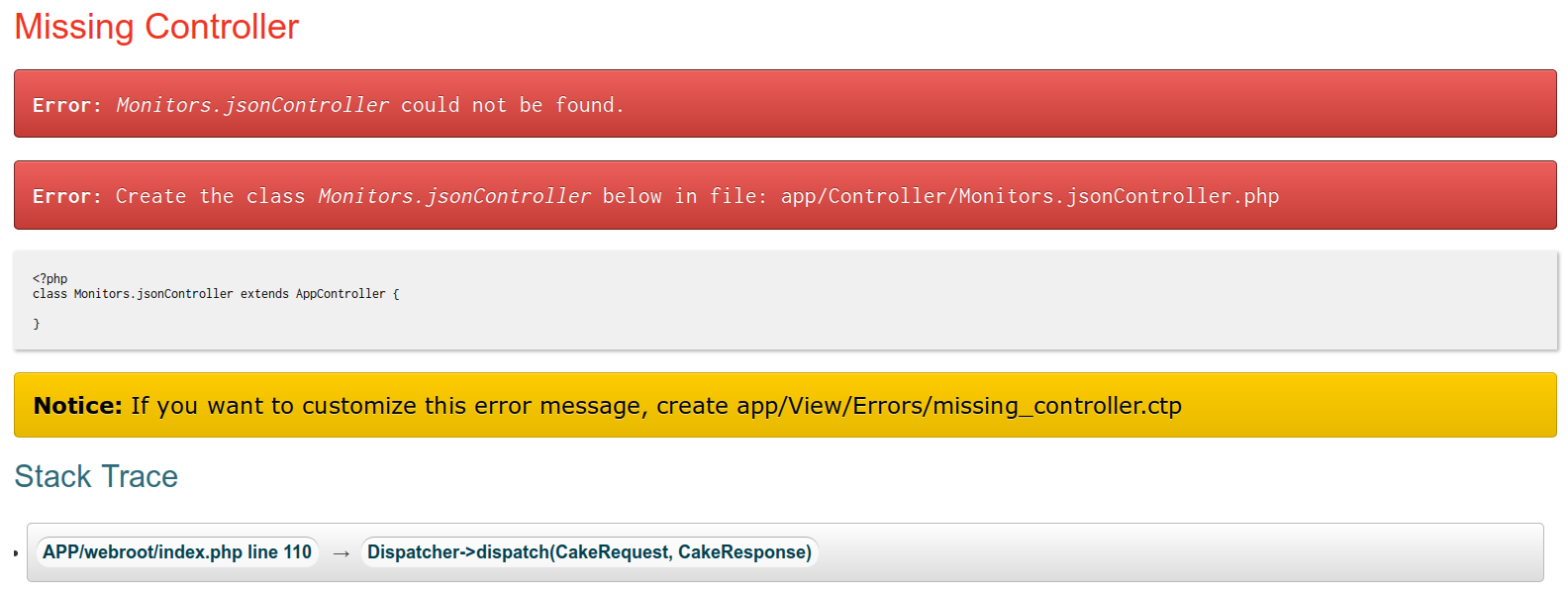

i've tryed 2.8.0 but i got errors (view attachment of http://zoneminderaddress/api and http://zoneminderadress/api/monitors.json)

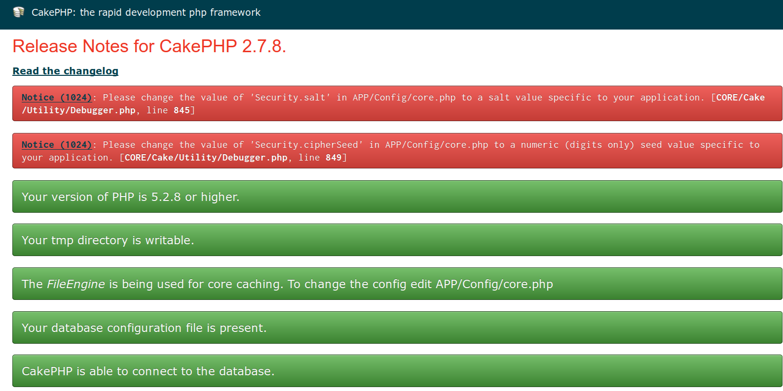

I've tried also with cakephp 2.7.8 installed by AUR repository but yet an error as you can see. Any ideas?

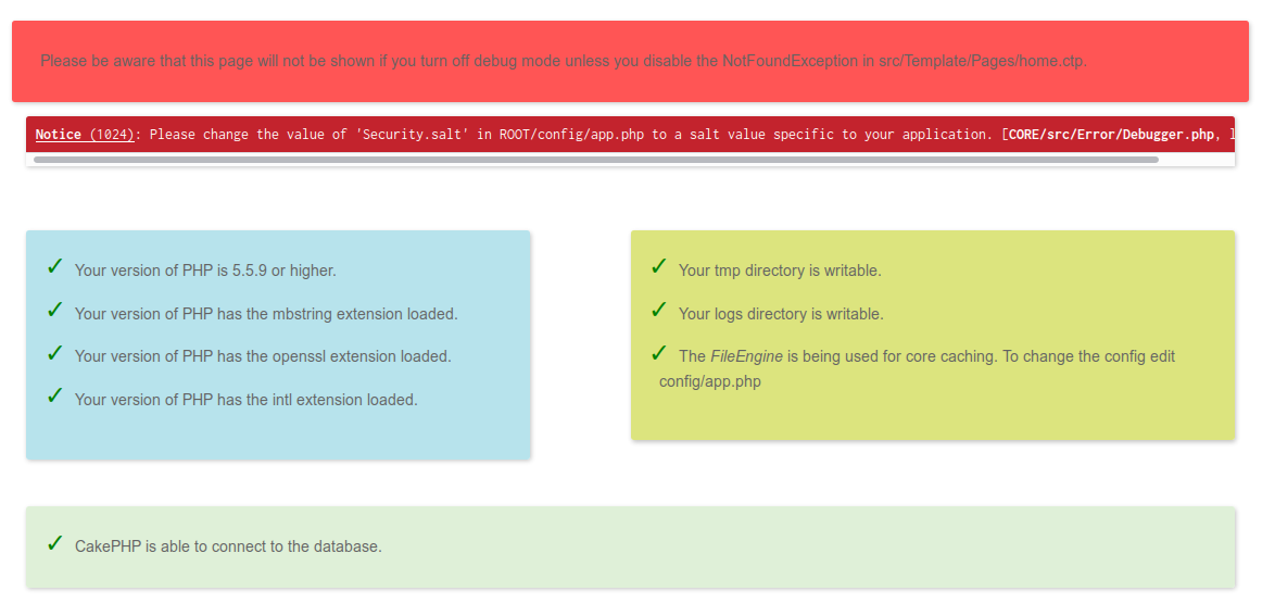

Ok, i've upgrade to cakephp 3.2 but... same problem: when i go to http://zmip/api i got a page which say:
Please change the value of 'Security.salt' in ROOT/config/app.php to a salt value specific to your application. [CORE/src/Error/Debugger.php, line 791].
I don't have enough experience to solve this. Maybe It has to do with secret encoding hashed authentication?
