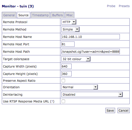

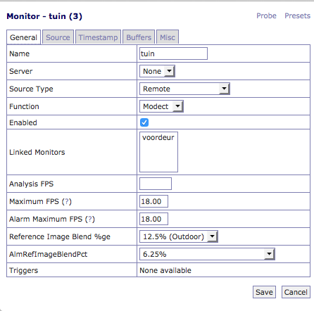

I am using zoneminder in combination with two C7837WIP vstarcam's. On Ubuntu 14.04 server edition on a HP microserver.
The Vstarcam C7837WIP cam's are Cheap and Chinese camera's which come with horrible software and horrible firmware as was to be expected for a dome camera at 40 bucks a pop. Still good value for money. Been a project ever since. Eventually got it working in the following manner:
source
source
general
general
there is one catch with these camera's. By default the resolution on the camera is set to 320x180. So after a reboot it is always set back to 320x180.
So when I set my resolution to 640x360 on the camera and in zoneminder. It works a treat. Until the moment a camera reboots for whatever reason. At that time the resolution goes back to 320x180. Which does not play well with the "source" camera resolution settings of 640x360 in zoneminder.

Dropped this whole log parsing thing. Was thinking about it all wrong. Instead I changed to rstp instead of http.
To achieve this I did the following:
At the camera settings under the general tab Change the source type to ffmpeg.
Switch the source tab and use RTP/Unicast as Remote Method. and set the following source path:
rtsp://username:password@camera_ip_address:10554/udp/av0_0
Set 32bit color and the resolution to 1280x720,
restart zoneminder.
That fixed it for me.
