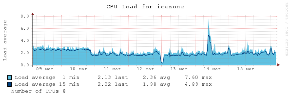

- 10 IP Cams, each has a high def stream (1920x1080) and a low def stream (320x176), 20 monitors total
- All cams set to 5FPS on both streams
- ZM does motion detection on the low def stream, hi def monitors linked to the low def
- System is a self built i7-3770 CPU @ 3.40GHz, 16GB memory, 4x2TB drives in a software RAID 5
System typically runs a load average just under 2. On partly cloudy days where's there's lots of shade to sun to shade transitions I see a noticeable increase in events and that pushes up the load average a bit.
Load average for the ZM system over the last week...
